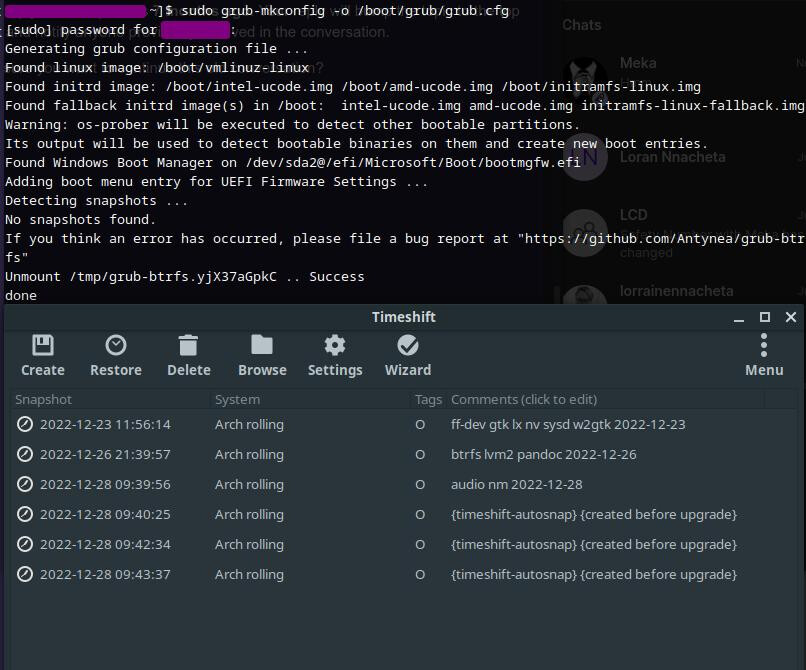

Months later… and I have now run into this issue as well. However, my timeshift is set to BTRFS and it still gives me the same error.
