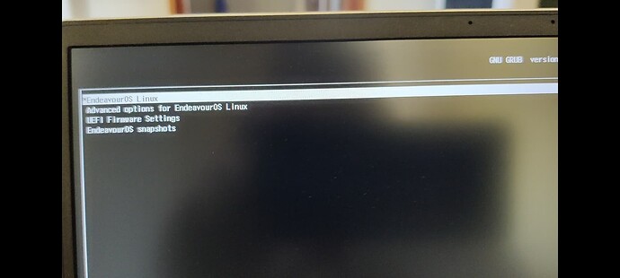

yesterday I updated my system and saw that there was a GRUB update, since there has been issues in the past with GRUB I’ve always been very diligent with checking what modules are getting updated and in particular if I see GRUB in the list I always make sure to run the following commands, as I did yesterday:
sudo grub-install --no-nvram
I updated the system, ran the commands, no errors reported and I moved on. Today I restarted and got greeted with a GRUB error:
error: no server is specified
error: no suitable video mode found
Here’s a pic I managed to grab with my phone since I couldn’t find a way to consult the logs.
I’m able to land on the console version of GRUB and boot normally, but following these messages GRUB is unable to launch into graphical mode, where it shows the theme I picked, I’m guessing there’s an issue with my grub config file, but I can’t figure out the problem since until yesterday it was working normally. Here’s my /etc/default/grub file:

As you can see from the config file I’m using an encrypted device, the screenshot is taken right after I inputed the decrypt passphrase and right before the GRUB screen where you can pick which Kernel to boot from, the 2 errors appear for a split second and then GRUB launches into console mode (black background with white text and no theme). I tried scavanging for answers, but all I could find were some obscure issues from 2018 which didn’t seem too related to my issue, I also didn’t hear from anyone having issues with GRUB after the most recent couple updates that took place in the last couple of weeks.
