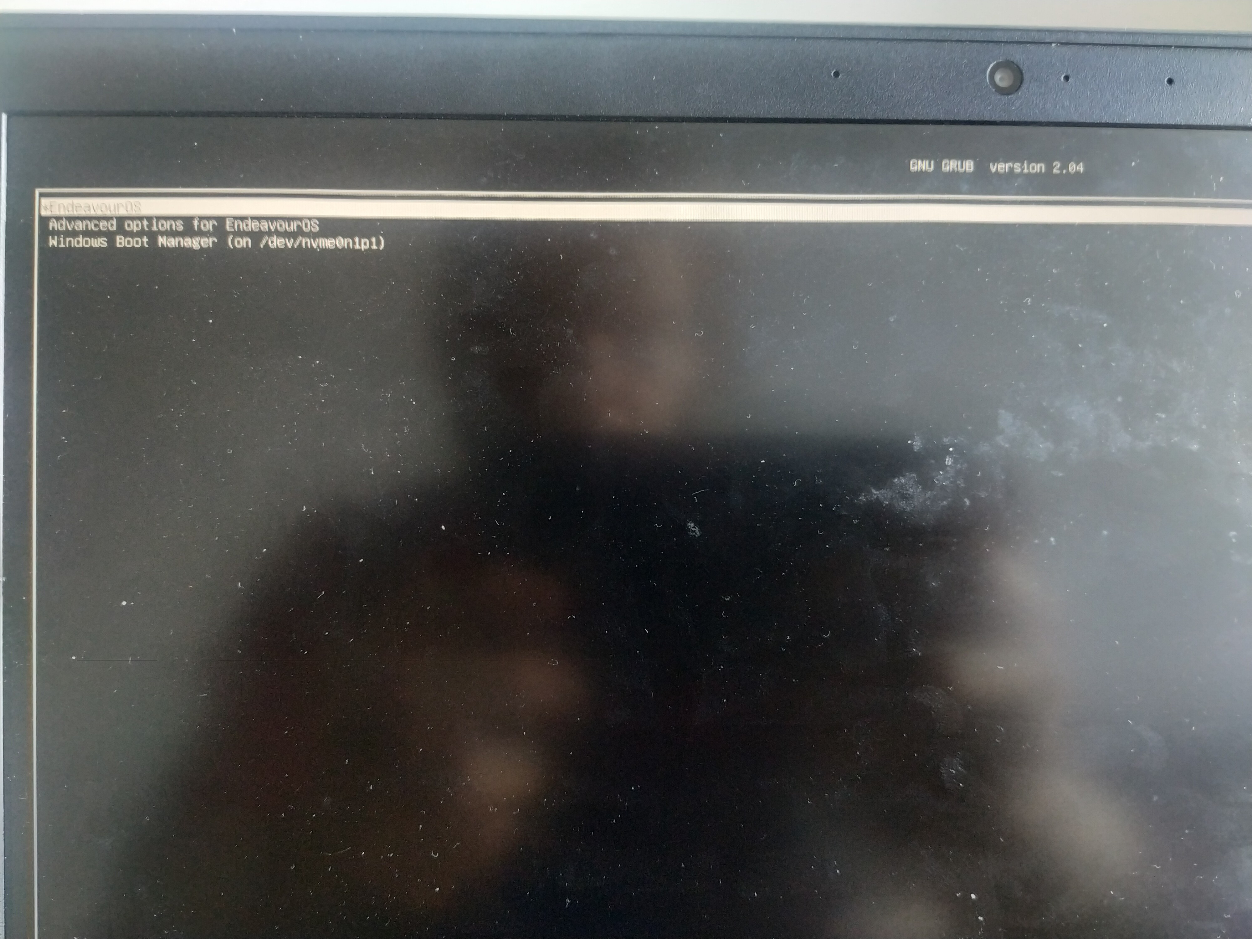

After rebooting:
IMG_20210131_132257
IMG_20210131_132331
So @pebcak still the same problem, except grub has now lost its styling.

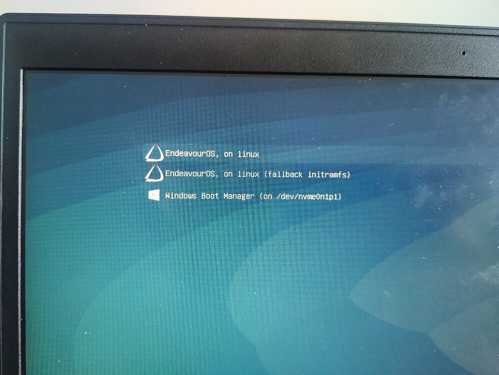

@pebcak @joekamprad @manuel I think I may have made some progress by combining suggestions.
Looking at the boot settings from the BIOS I noticed ubuntu in the queue
IMG_20210131_135733
I figured this was wrong and guessed that NVMe0... was instead my efi partition, i.e. /dev/nvme0n1p1 when looking at fdisk -l

As such I moved this EFI partition to the top and deleted the ubuntu partition, after rebooting I was put directly into image so I figure this was at least partly successful.
The final remaining thing is that efibootmgr -v still has no entry for eos as it did for me in an earlier post.
