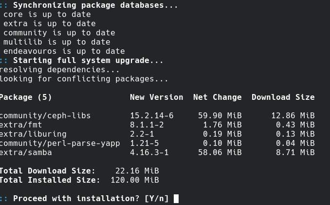

BTW, care to explain this? Your contention is that Samba is needed for Dolphin. And it is installed to satisfy that dependency. And yet on my laptop where I have never installed Samba I get the following:
Screenshot_20220720_031639
Why would I have to install Samba if it is already installed?
Screenshot_20220720_031853
Ah, it isn’t a dependency. So, not sure what you’re referring to. So, your notion that installing it broken as a security feature falls flat.

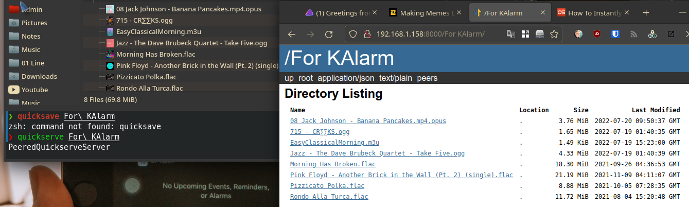

I like quickserve for a quick 'n dirty file sharing session.

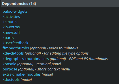

Dolphin requires smbclient package.
Understood. It does look useful but not suited for my needs. Thank you for the suggestion.
You do realize smbclient isn’t Samba. It’s in the name, client. Also, you know what requires it? Samba. Not the other way around. So, again, no you do not need Samba for Dolphin and your notion that it should be shipped broken unlike every other service I’ve seen thus far for “security” is false.

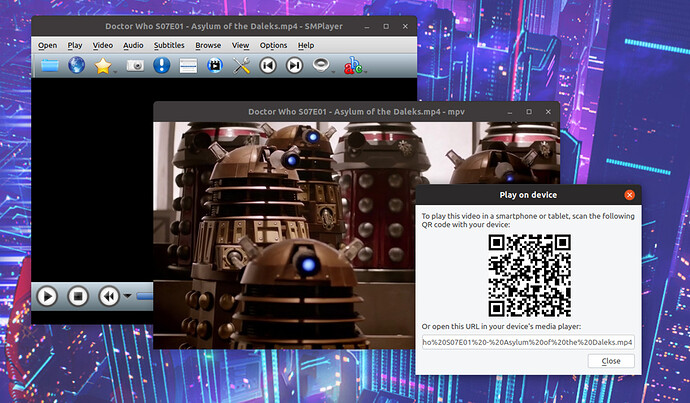

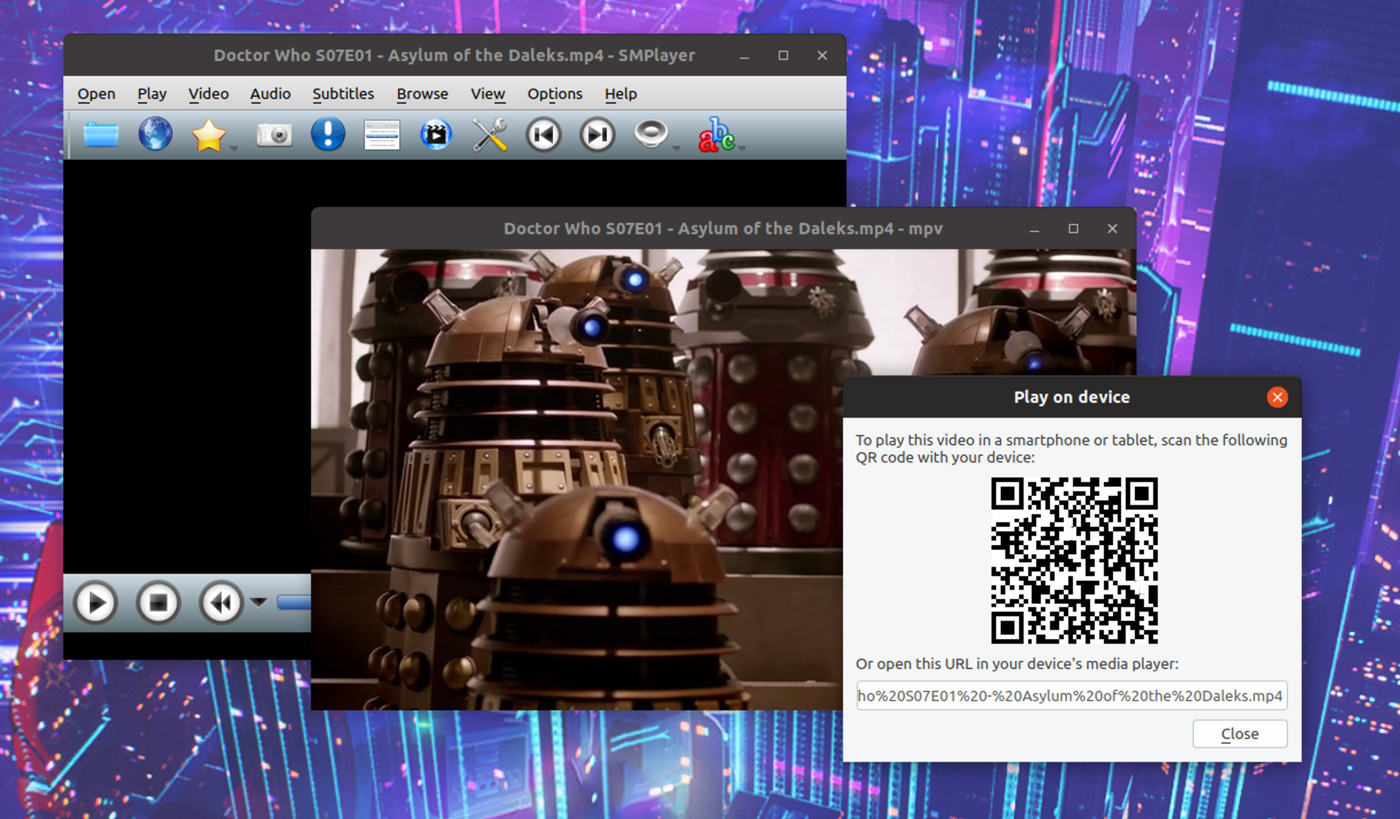

I see you mean access to remote video in Linux Desktop without file transfer, SMPlayer is a simple solution and supports that without samba, just using http protocol in your own network. That works fine for me.
Thanks for the suggestion, but not suitable to my needs.
The reason I use SMB for access is because I want to be able to share files to my tablet privately. The earlier suggestion of Quickserv does not work as it allows anonymous access to a directory via HTTP.
While this is more secure, this does not work because you’re scanning a QR code to initiate access. This defeats the purpose of being anywhere in the house on the tablet and accessing those files. I’d have to go back upstairs, unlock the main rig, initiate the connection, then return to where I was.
