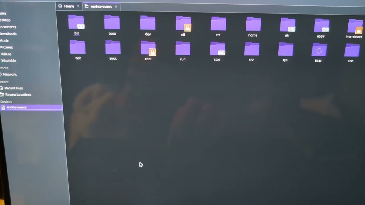

Laptop has RTX 4050 and Intel Arc graphics. Intel Ultra 7 155H CPU. Wasn’t happening on Windows. Happens on X11 and Wayland. Have updated software. Happens on hybrid, Intel only, and Nvidia only.

Tried that. Still seems to happen.
