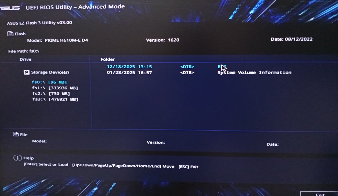

Yes there is an update available for the motherboard firmware. I havenât flashed the new BIOS because Iâm not sure how to do it. My current version is 1620, released in December 2022 (screenshot attached for reference). I see that the newest version is 3810, released in December 2025, but I am hesitant to update because Iâm afraid of bricking my motherboard.

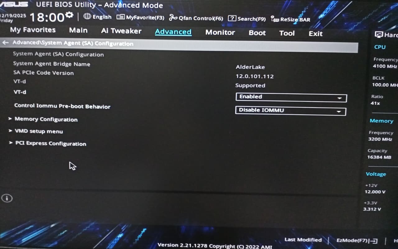

I rechecked the BIOS âAdvancedâ tab and also looked at the manual again. In my specific case, the option that is shown in the manual under âAdvanced\SA Configurationâ is not visible. I have attached a screenshot for reference.
After hours of debugging and gathering the courage to do so, I have successfully updated my BIOS to the latest version (3810). Unfortunately, the problem still persists."
