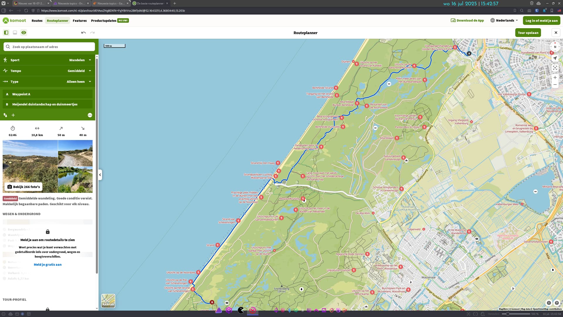

I am still in my test phase for chromium based browsers. Yesterday I realized that brave is not showing the inline maps of the komoot.de webpage. When I turn off GPU acceleration it works. I opened an issue for it with screenshots:

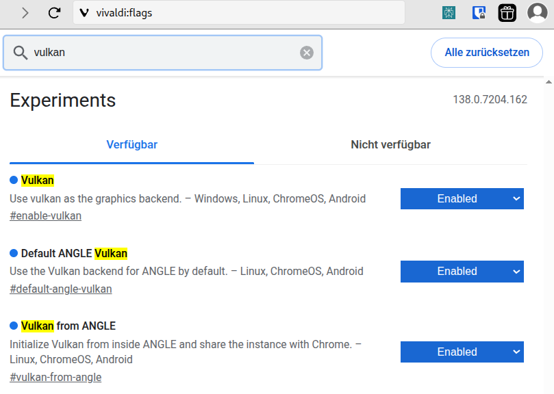

Your vivaldi says: Vulkan: Disabled
Mine says: Vulkan: Enabled
Can you test with vulkan? What does vulkaninfo say on your system?
You can enable vulkan in vivaldi://flags
Cpu is a ryzen 5 7600 with IGP , with vulkan enabled there is no problem .
