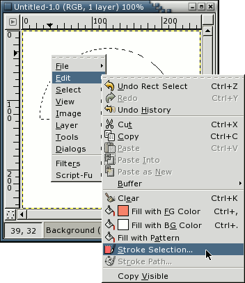

If I understand correctly what you want to do:
Edit > Stroke Selection
A popup menu will appear to select the color and the thickness of the line.

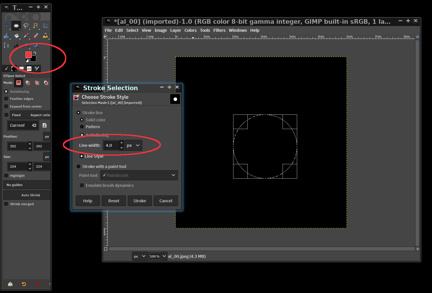

I mistakenly wrote that the popup window contained the color selection - it doesn’t, the color selection is in the toolbox. My memory was a bit faulty.

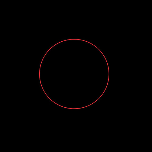

That will give you this end result, which I think is what want:

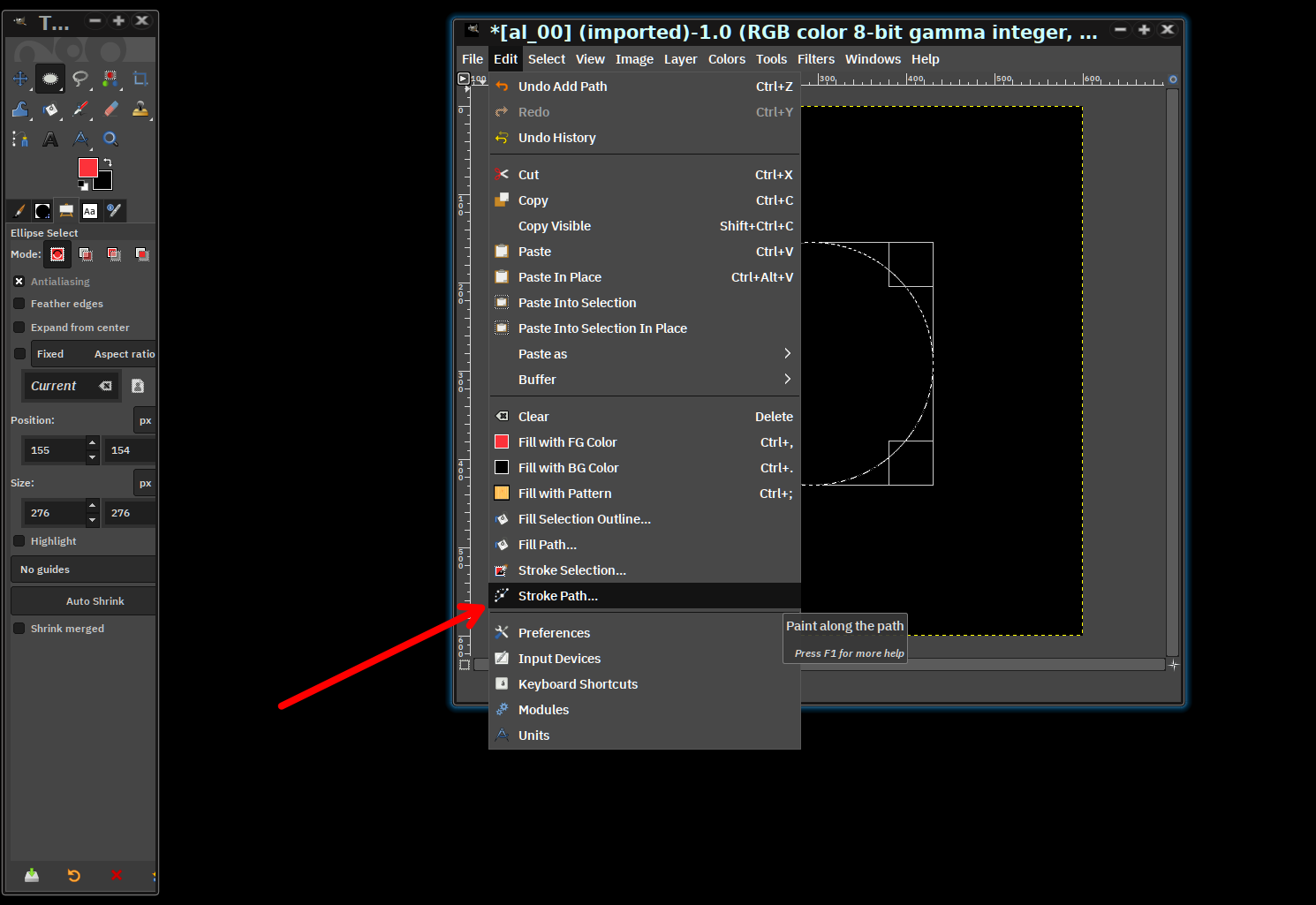

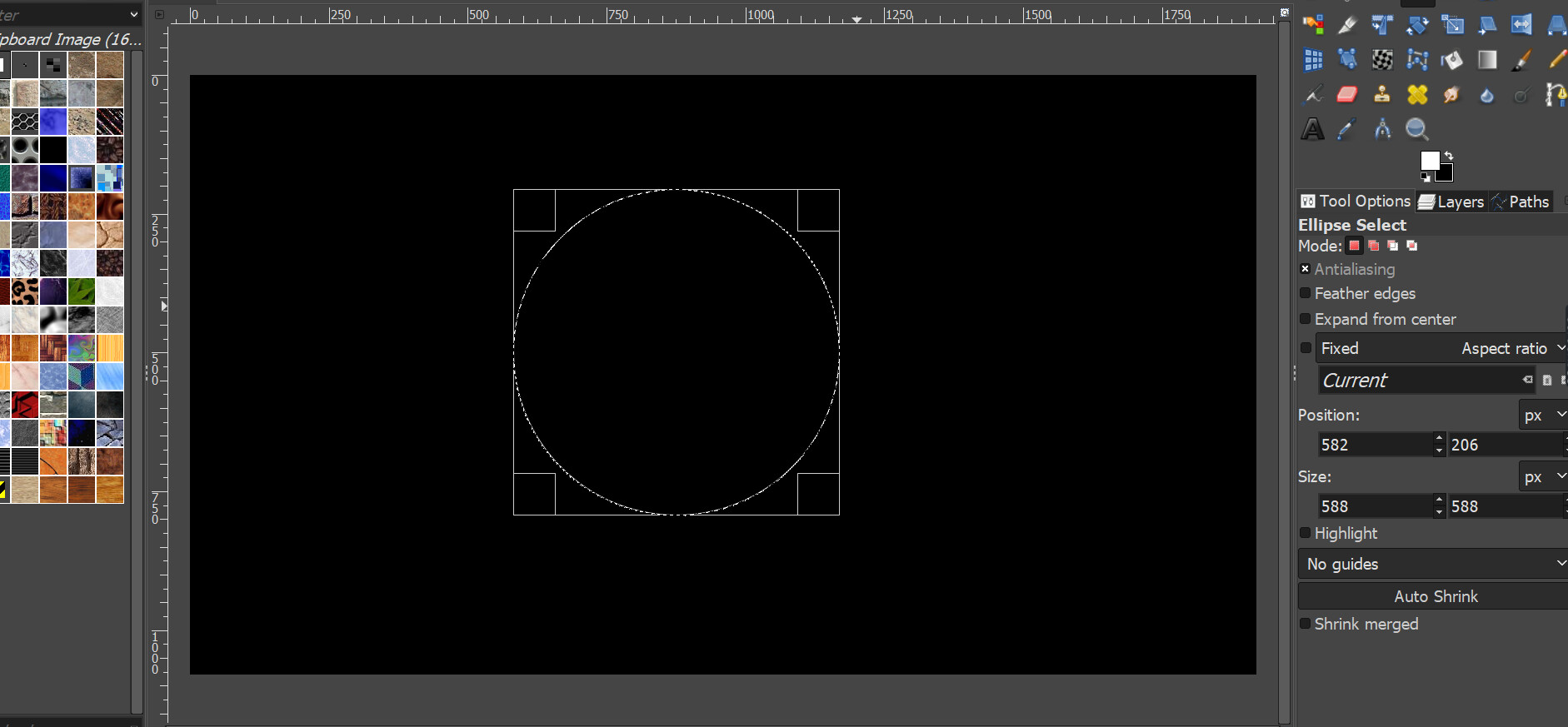

You can get a smoother looking circle by converting the ellipse/circle selection to a path, then stroking the path. It’s one extra step: create your circle with the Ellipse tool, then Select > To path, then use Edit > Stroke path instead of Stroke selection.
That makes the edges look smoother, which may or may not be important to you.
