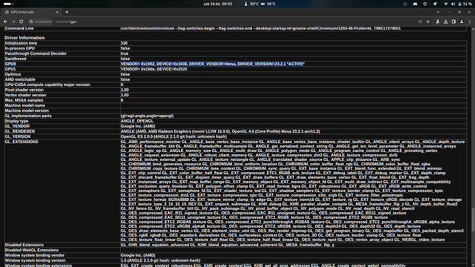

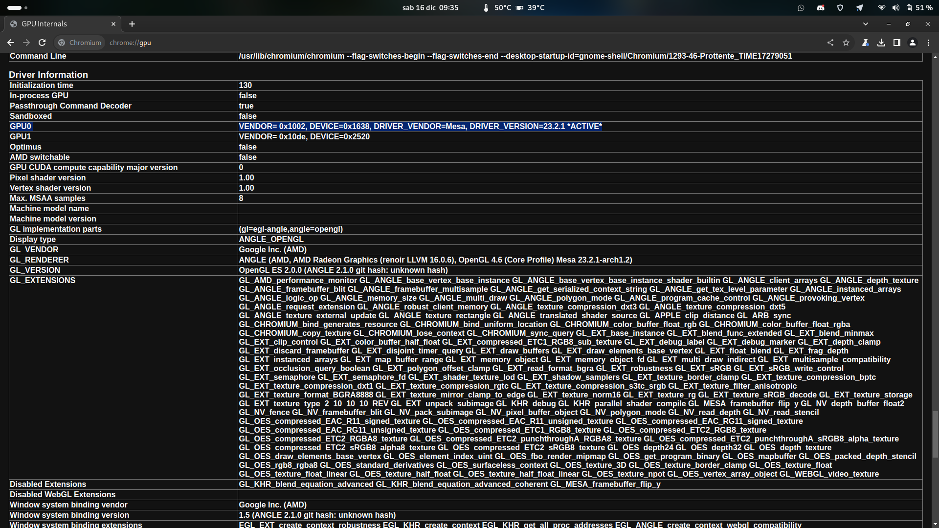

I installed Chromium and it work on integrated GPU.
chromium about-gpu-2023-12-16T07-46-39-951Z.pdf (173.2 KB)

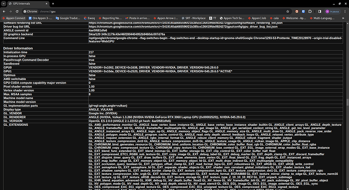

On Chromium the gpu0 is actived, on google chrome is the gpu1, but i saw some differences on the used video drivers.
This is Google Chrome
This is Chromium

This is a vulkan issue on google chrome. Recent chrome versions enabled vulkan by default, but its broken beyond belief.
As we can see from your screenshots on google chrome display type is ANGLE_VULKAN, but on chromium its ANGLE_OPENGL.
Try disabling vulkan: open new tab, go to chrome://flags, find vulkan option, select disabled and restart chrome (don’t click on relaunch, because that does not work most of the time, close the browser and open it again manually).

Thanks a lot @jake99 .
Disabling vulkan on chrome://flags fixed the problem!
