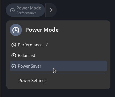

This is what I see in the setting menu:

Interesting. On my system there is no Performance Power mode
Looks like that performance mode is not available in all systems.

You can switch between the last one use and the default one just by clicking on Power Mode, without having to go to the arrow menu.
What I want to do is just go from Power Saver to performance and the other way round just by clicking on Power Mode.
The only way I can think of is removing the Balance Profile, but I want to leave that as a last option
Perhaps a shortcut for powerprofilesctl ?
