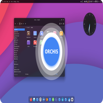

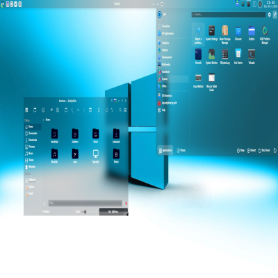

For example, these Global Themes for KDE 6.0:
As you can see, it looks transparent with blur, but when I install it from “Get New…”, Dolphin it looks totally opaque.

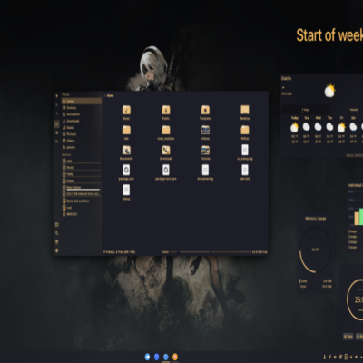

What I really want is this, but I don’t even know how to get it:

That last screenshot is definitely kvantum. That first link to the Stone theme shows only screenshots that use the Lightly theme. It was a nice attempt at making a new application theme, but development basically stopped from what I remember. That Orchis theme also looks to be using kvantum in the screenshots. Basically take a lot of those themes with a grain of salt.
