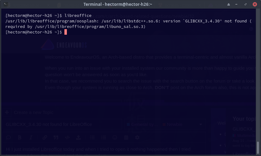

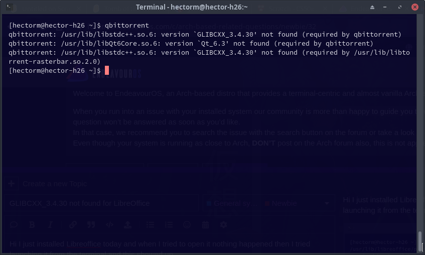

Hi I just installed Libreoffice today and when I tried to open it nothing happened then I tried launching it from the terminal and this showed up
the same happened with qbittorrent
