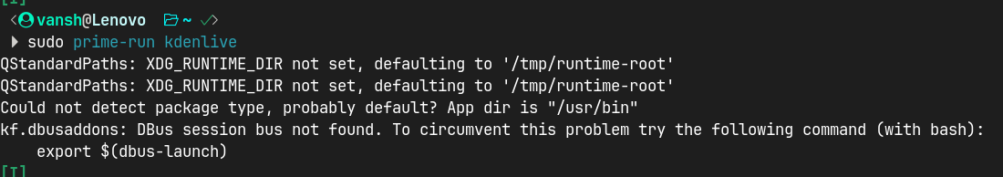

Getting this error when tried to run kdenlive with my dgpu
That is because you are trying to run kdenlive with sudo. You shouldn’t be running that as root.
ah ok thank you !
