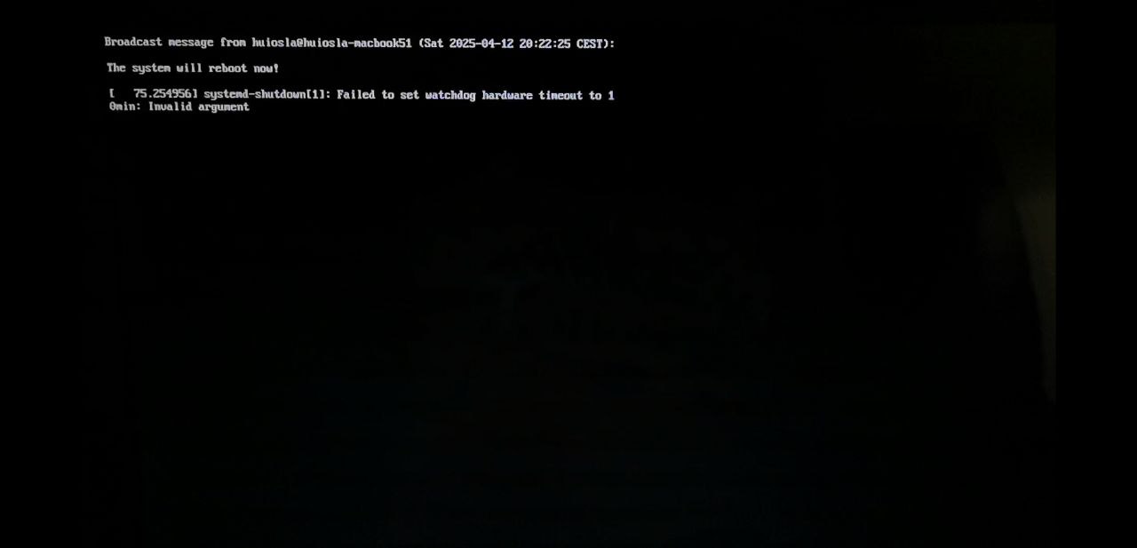

All of a sudden I have started to receive a weird momentary console message from systemd about something related to watchdogs? (I have no idea what this is). The message says:
#systemd-shutdown[1]: Failed to set watchdog hardware timeout to 1.
Omin: Invalid argument#
See the screenshot attached as well.
This message appears just for a fraction of a second and does not impede the use of the laptop in any way, but it’s visually unappealing and annoying, since I don’t understand why it appears and how to disable it.
I tried browsing through the web, but found nothing similar, or at least any possible solutions to it, so perhaps you people could help me figure it out?

I mean, you are right, but first and foremost:
  1. Why does this message even appear?
  2. It’s ugly and unneeded, hence I want it to be removed
    The linked article, from my understanding, instructs how to enable this watchdog thing, but I don’t need it at all. Can I just delete this watchdog? Or somehow silence it completely?

I have the “nowatchdog” parameter specified in my kernel parameters. I have also added the “nmi_watchdog=0” parameter in there, just in case, as the issue was still persistent with just the"nowatchdog" parameter.
So I’m kind of stuck here, as these basic kernel parameters don’t work, unfortunately.

This command does not give any output.
Also, I have confirmed through the “journalctl -b | grep watchdog” command that the only watchdog references I get are from my kernel parameters. But nevertheless, I keep getting this “failed to set watchdog hardware timer” error.
Maybe I really need to try and set it in the first place, I don’t know.
But why does this error still keep appearing if I have allegedly turned off everything watchdog related?
Thanks a lot in advance
