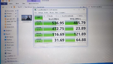

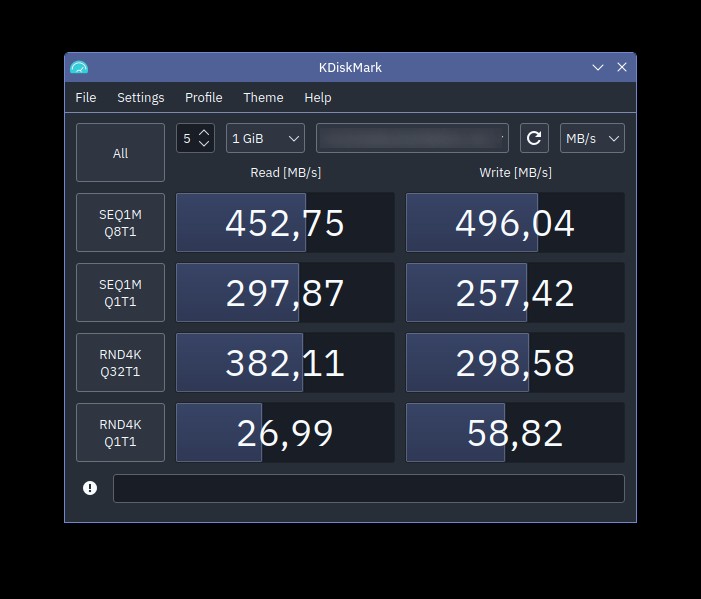

I tried in windows to benchmark my SSD and got 550mbps their however in endevouros it is almost half to it. Previously on debian I got the same results.

I have two 500 GB BX500, both achieve 450 MB/s plus.
Ohh, what should I do then, I have 16gigs of ram, i5 3470, and I bought SSD 15 days ago. I’ve got good speeds on windows though, and I checked for updates but all are up to date, I am happy with 250mbps+:smiling_face_with_tear:

Yeah it supports, and it’s i5, and I do get speeds over 550 Mbps in win, other wise it doesn’t bother me, but the same thing getting better speed in win makes me enquire about
