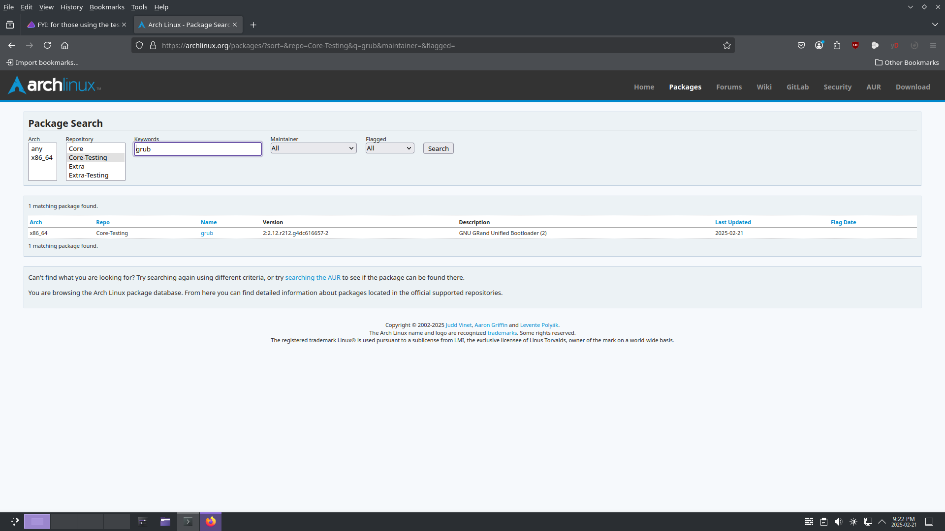

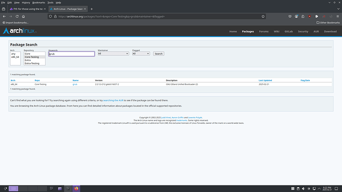

I’m also on grub 2:2.12-3. I don’t see any new grub version in testing.
Edit: It’s in core testing.
@anon26269396, @_Six: my EOS workstation is also on the 2.2.12-3 version. The version I mentioned was from the core-testing repo.
It was just posted sometime today.
I see, thanks for clarifying, my mistake, I didn’t realise it was from testing.
