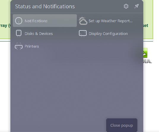

Fuzzy/aliased text on transparent windows with blur enabled when the background behind a window is white

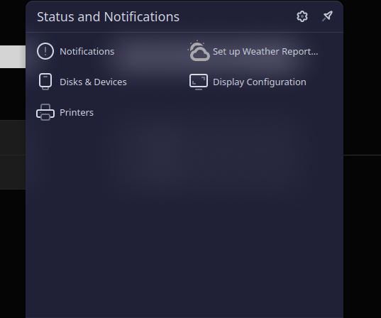

For some time now on Plasma 6, notification windows or any window with blur enabled will cause the text displayed within it be fuzzy or aliased (for lack of a better word) when the background behind it is white or bright. Example images are attached:
Does anyone using a plasma theme with blur enabled encounter this issue? Or is it something to do with my system specifically? I use Darkly for my Application Style, but that seems to not affect it as when I change back to breeze the behaviour is the same. The plasma style in the picture is Amethyst, but it happens with others that use blur as well.
And a final question, is this a known bug?
Apparently this happens even with blur disabled. Has anyone running KDE encountered this issue at all or is it some other specific issue? I just need an answer to have peace of mind.

Nothing changed. Same behaviour. I presume this is an issue that won’t go away unless I do a reinstall if this a circumstantial bug that is probably related to old plasma5 configs and packages (or maybe some other unknown issue)

For Rendering backend I switched to Vulkan to fix some issue I had with an app I don’t remember.
Oh?
Might we try OpenGL or reverting to ‘auto’ ?
No change. Unless a reboot is needed.
I think a reboot would be needed.
What is the result?
Unbelievable, that was the issue. Thank you. Went back to auto.
