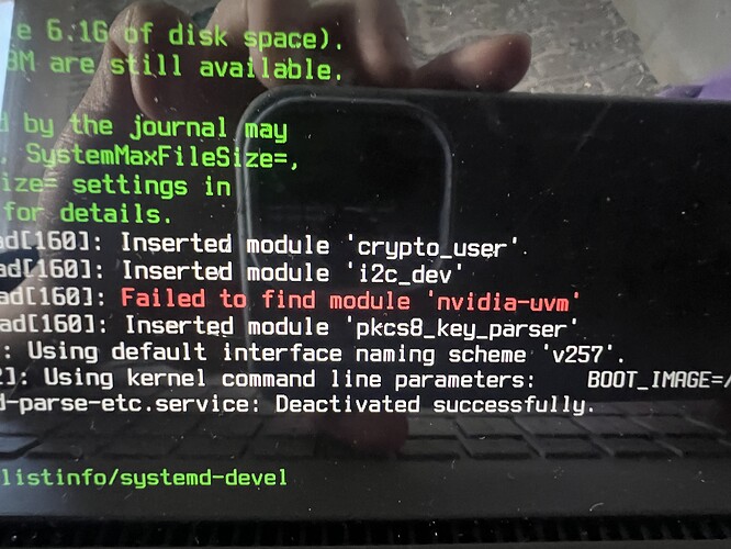

hi folks. i could use some help. i’ve been running duel boot endeavouros and windows 10 on a microsoft surface book 3 for about two years. it was initially installed and managed by someone with much more experience than me, but ive been doing it on my own for most of that time, and contacting them for help is no longer an option. ive taught myself quite a bit and until now ive been able to solve any problems that have arisen with help from past forum posts, but i’ve finally hit a wall.

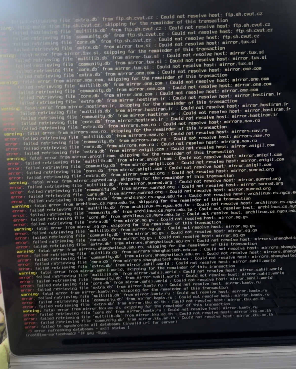

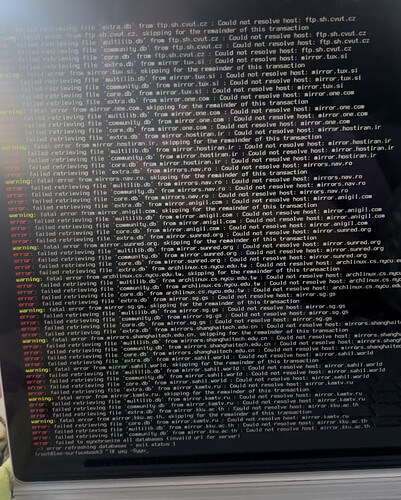

yesterday i updated my system using yay, as i do about once a week. everything seemed normal and i rebooted as usual. the system booted without a problem, but once the login screen appeared, it was completely unresponsive. no keyboard, touchscreen, or track pad reaction. i can’t log in and I couldn’t get to tty from that screen. i did some digging on forums and managed to get to tty from the boot settings. i looked through my journal log and it seems like the problem is nvidia-uvm. i tried what i saw recommended on other forums ( -Syu nvidia-uvm) which i think would work, but all i got was a slew of warnings and errors about my mirrors (see images below). it seems like my computer isn’t connected to the internet. i couldn’t get wlan0 connect, so i got an ethernet to usbc converter. the system is registering it but won’t connect to it. so far i haven’t found any forums that have helped with the ethernet problem.
i’ve also tried downgrading nvidia and downgrading the whole system, which just produces the same mirror errors.
because it won’t connect to the internet, i can’t post the journal or errors directly, but i’m including pictures of the things i’ve mentioned. if there’s any other info that could help yall let me know.

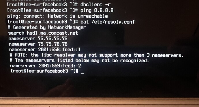

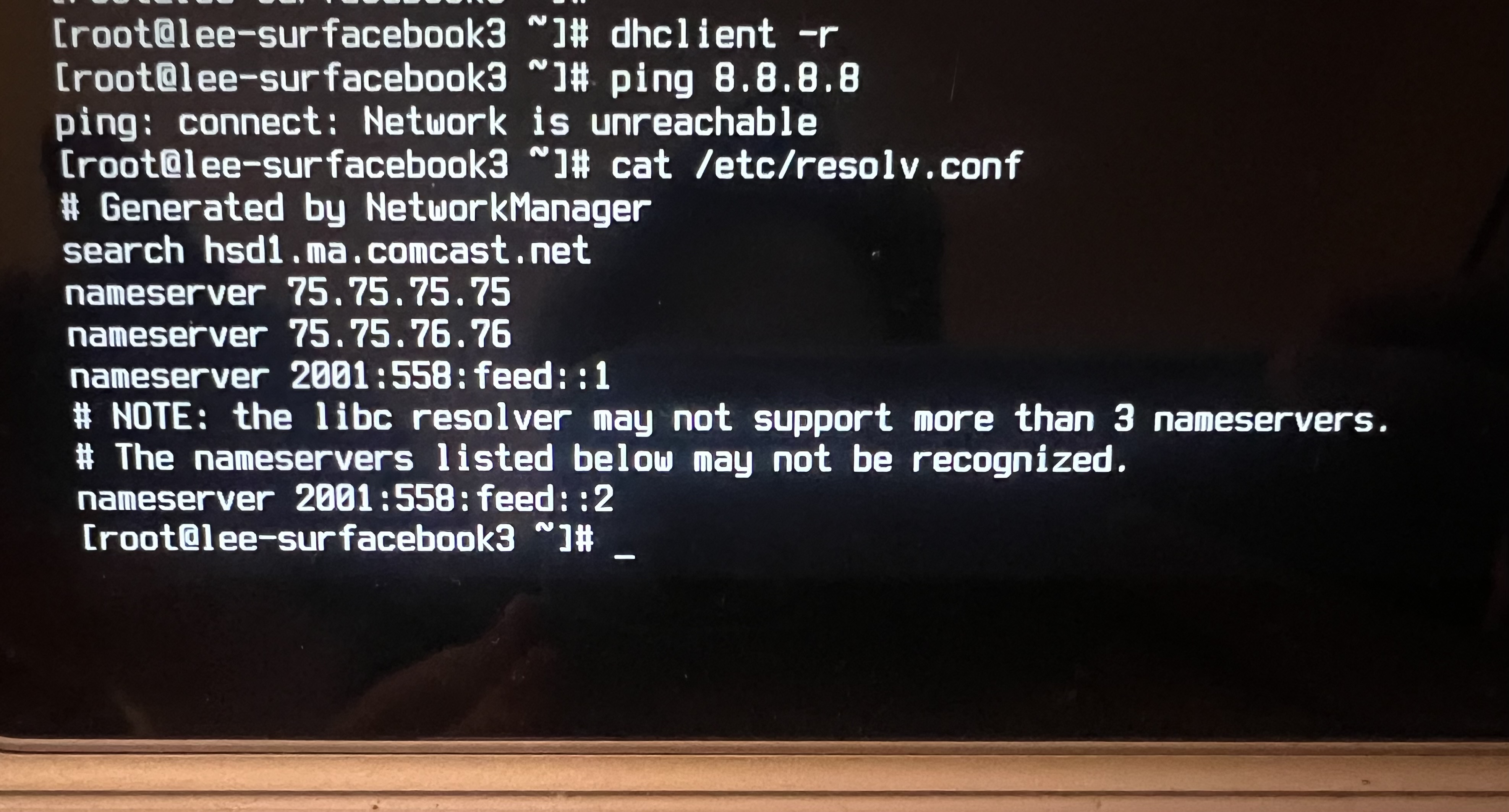

Then try ping 8.8.8.8 to see if the network is live. then try ping endeavouros.com. If it can’t get that then the DNS is still down, so inspect that with cat /etc/resolv.conf

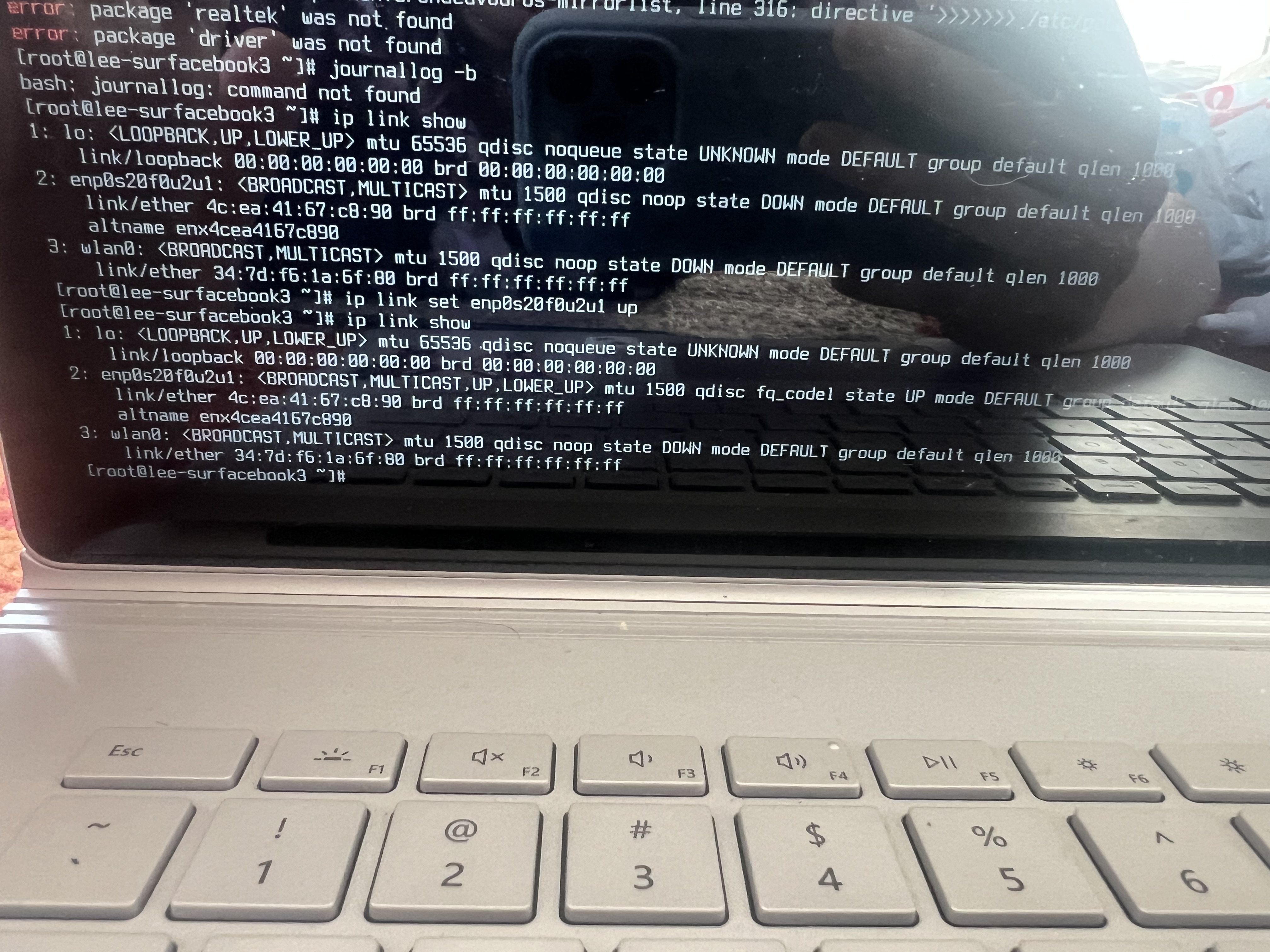

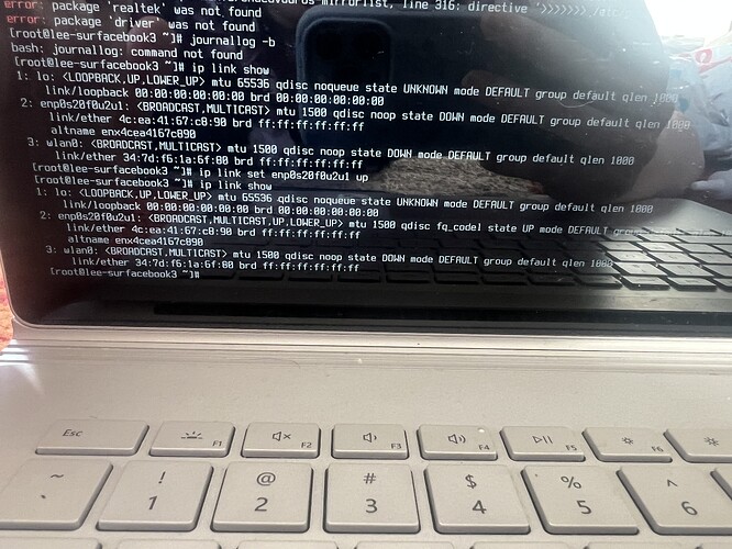

dhclient -r doesn’t seem to have changed anything. I’m getting “ping: connect: Network is unreachable” when i try to ping 8.8.8.8
this is what cat /etc/resolv.conf gives me
Add the interface name to the end of dhclient -r enp0blahblahblah
I’m still getting network is unreachable. i made sure the network’s state was up, i also tried the alt name. no luck either way unfortunately
