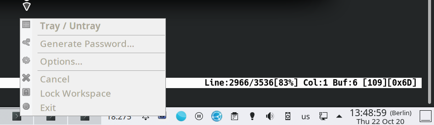

I notice “keepass” package freeze on me everytime i press middle mouse button on it. The way it freezes is by dissappearing the window of keepass, but left the tray icon there. Right click on the tray icon, a menu window appears with everything greyed out. I can’t open new instance of keepass when it is not closed.

1.Kill windows , but since no window appears, hence not usable,.
