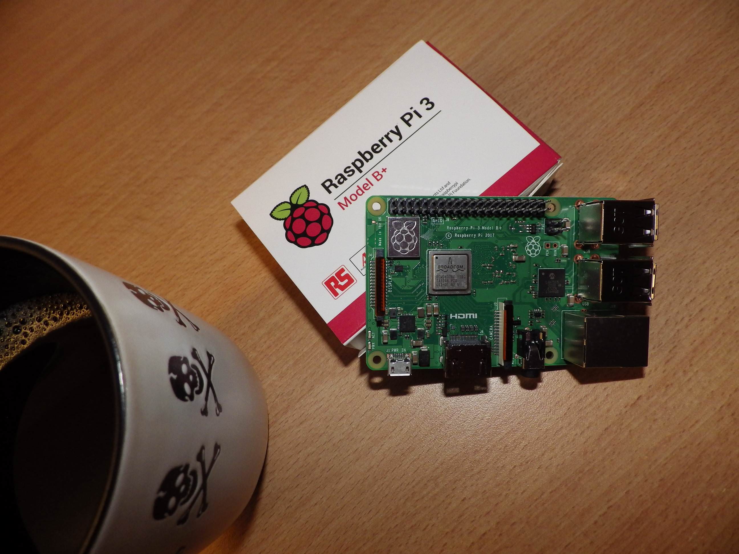

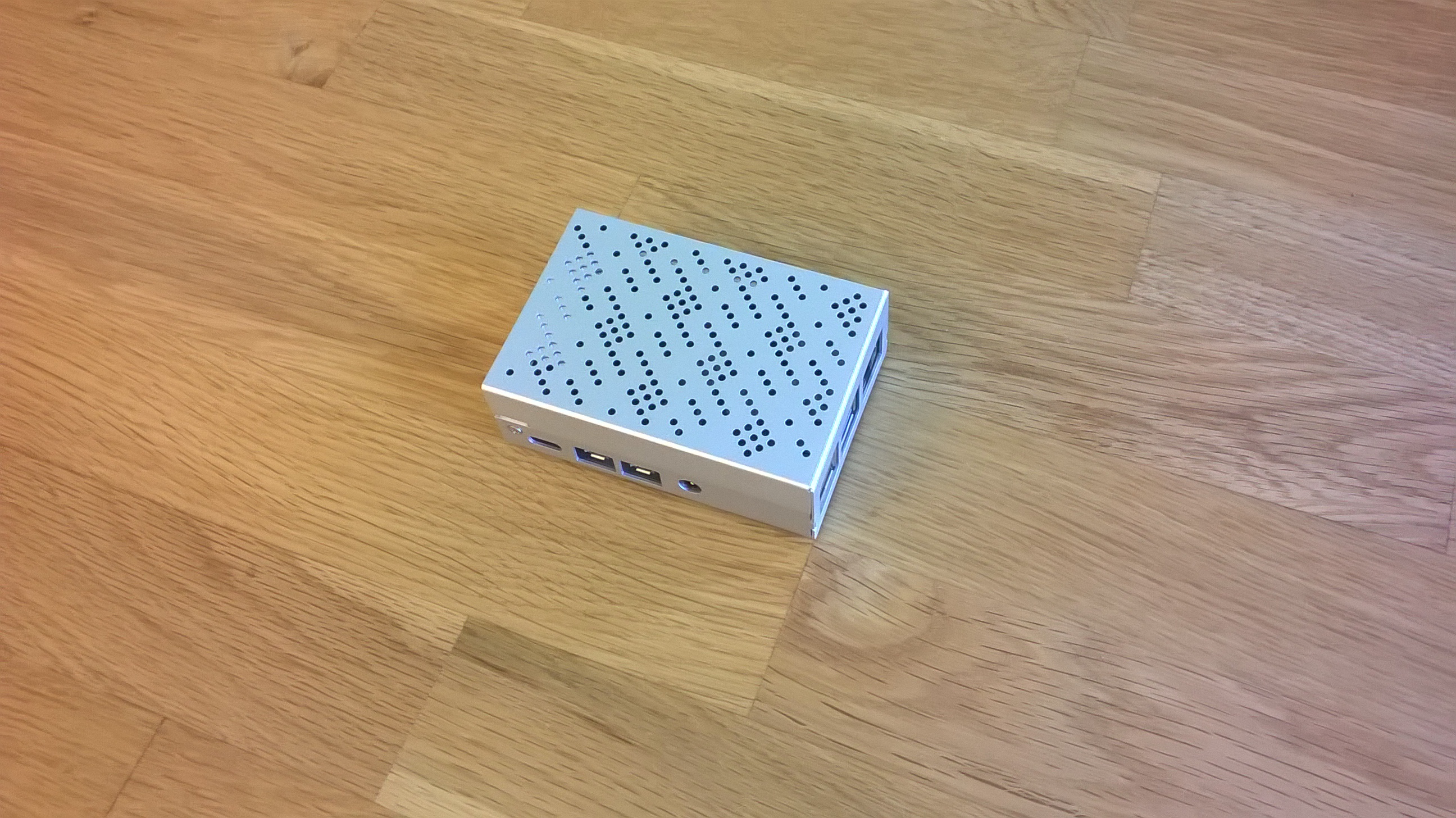

I love RPi. Used to tinker with them a lot before!
I do not know if you like pictures, but here are some of them:
20201007_145234 20201007_145240
:smile:
