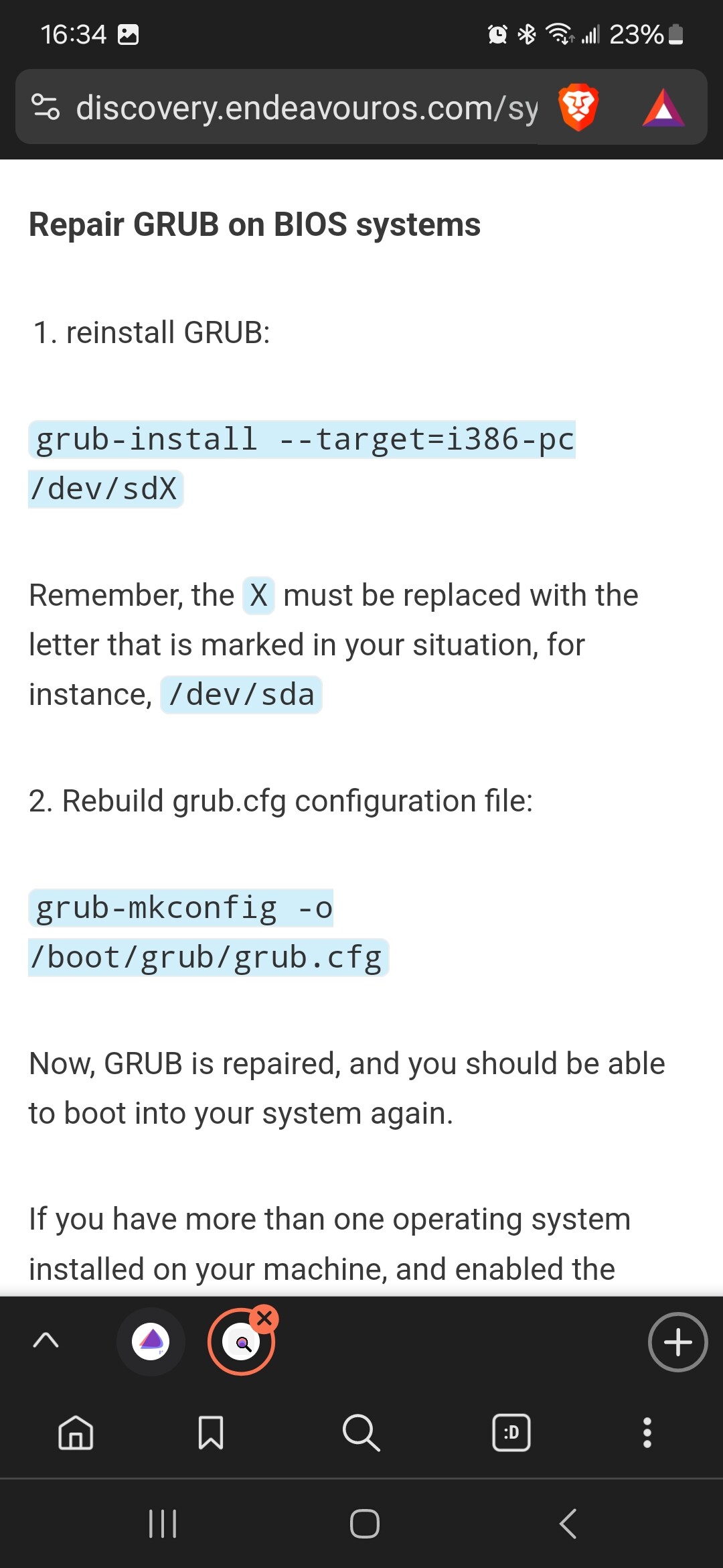

Those commands are for a legacy BIOS installation. If you have an EFI partition you should be following the instructions below that:

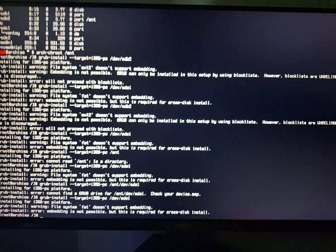

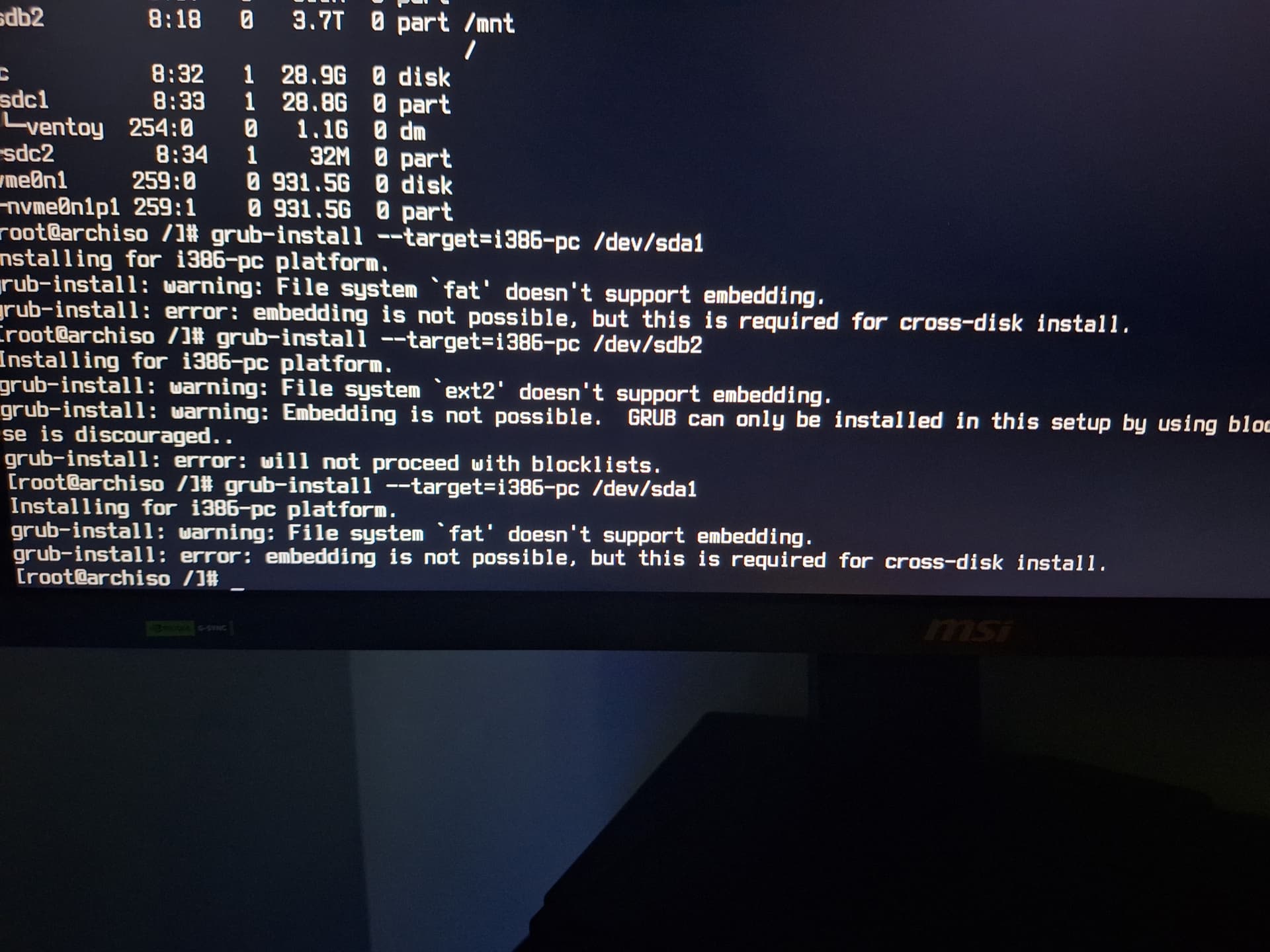

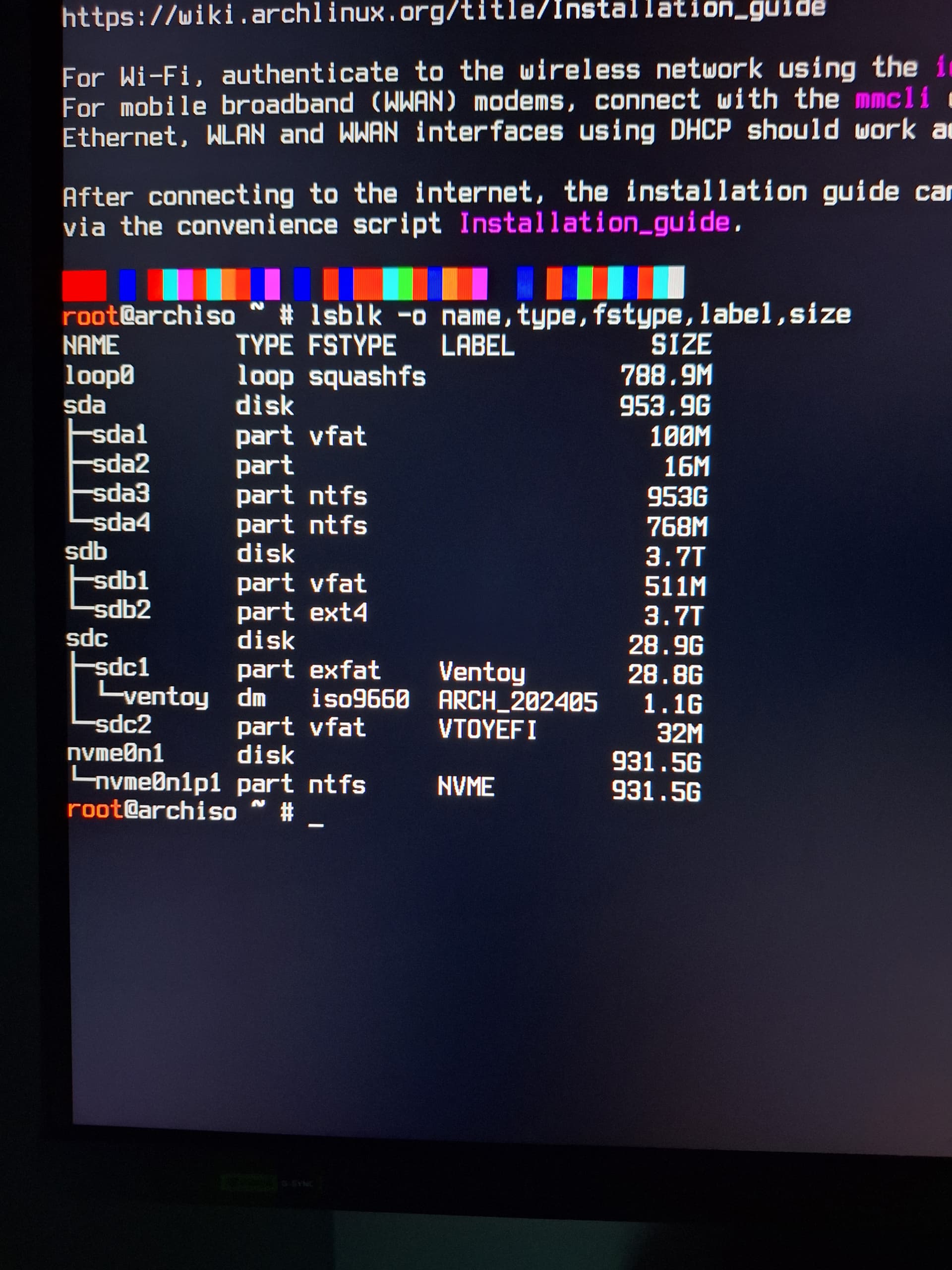

Additionally, it doesn’t look like the chroot is set up right. Are you sure /dev/sda
is the right disk? There is an error message about ext2 on there; it would be odd if you were using that filesystem for your EndeavourOS installation.

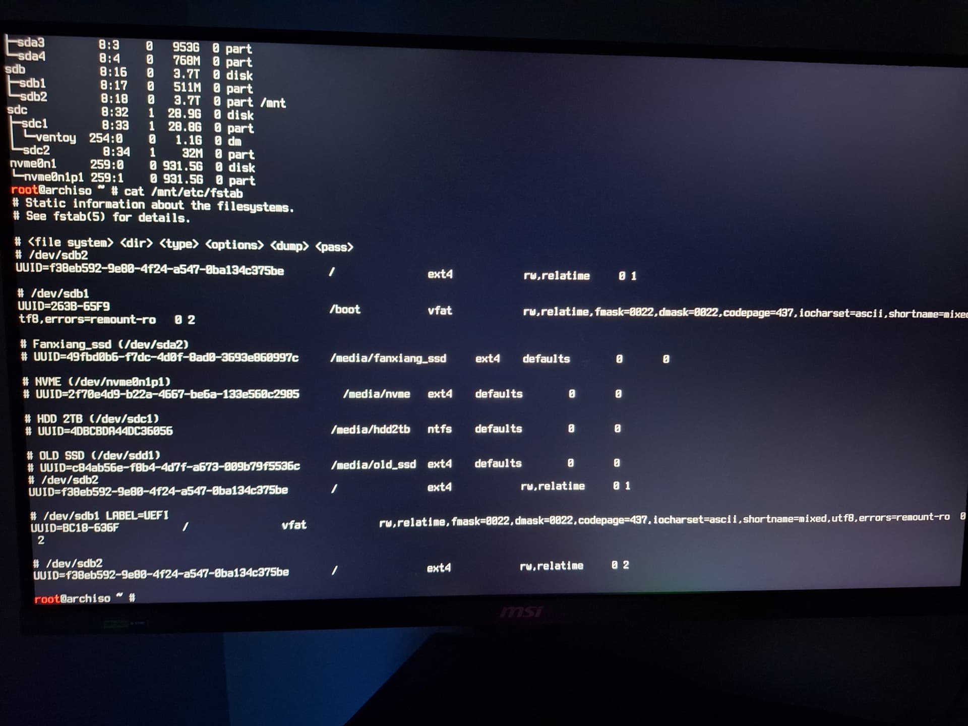

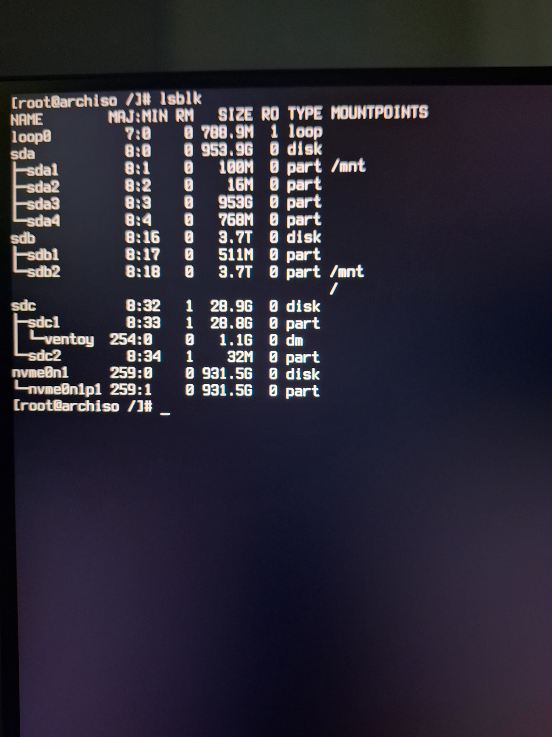

Also, it doesn’t look like the EFI partition has been mounted correctly. See the instructions in this article: https://discovery.endeavouros.com/system-rescue/arch-chroot/
So we need to mount /dev/sda2 and the ESP (/dev/sda1) make sure to know your ESP mount point on your installed system can be /efi or /boot/efi (older installs, or if you are using grub instead of systemd-boot).
You will see in the /etc/fstab file of the installed system if you cannot remember.
sudo mount /dev/sda2 /mnt
sudo cat /mnt/etc/fstab
(to check the mount point of your ESP)
sudo mount /dev/sda1 /mnt/efi
(or /mnt/boot/efi)
Now your installed system is mounted.
Run arch-chroot to login to the installed system
With this information, you are able to arch-chroot, so type the following command:
sudo arch-chroot /mnt
