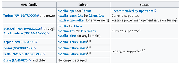

Nvidia has moved to open drivers for newer gpu’s. See here.
Ohhh good to know!! Should I go for nvidia-open-dkms or nvidia-open?

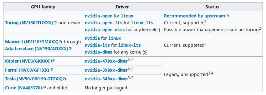

Though I thought my 4070 would be Ada Lovelace so the dkms should’ve be fine according to that chart..? I don’t really get the versioning of this stuff, the Turing appear to be older than the Ada Lovelace…. Actually I’m not gonna question this all anymore and just go for nvidia open and hope it doesn’t explode my initram like switching to nvidia-dkms from nvidia-lts did.

I was under the impression that the nvidia-dkms was for cards up to 3000 (3050 etc) I thought the 4000 series was the next architecture up, but as you stated, they are Lovelace, I thought they were Turing

The whole versioning confuses me because according to this, the RTX 20s are Turing, which I think would be older than mine??? I’m just confused about this as a whole
