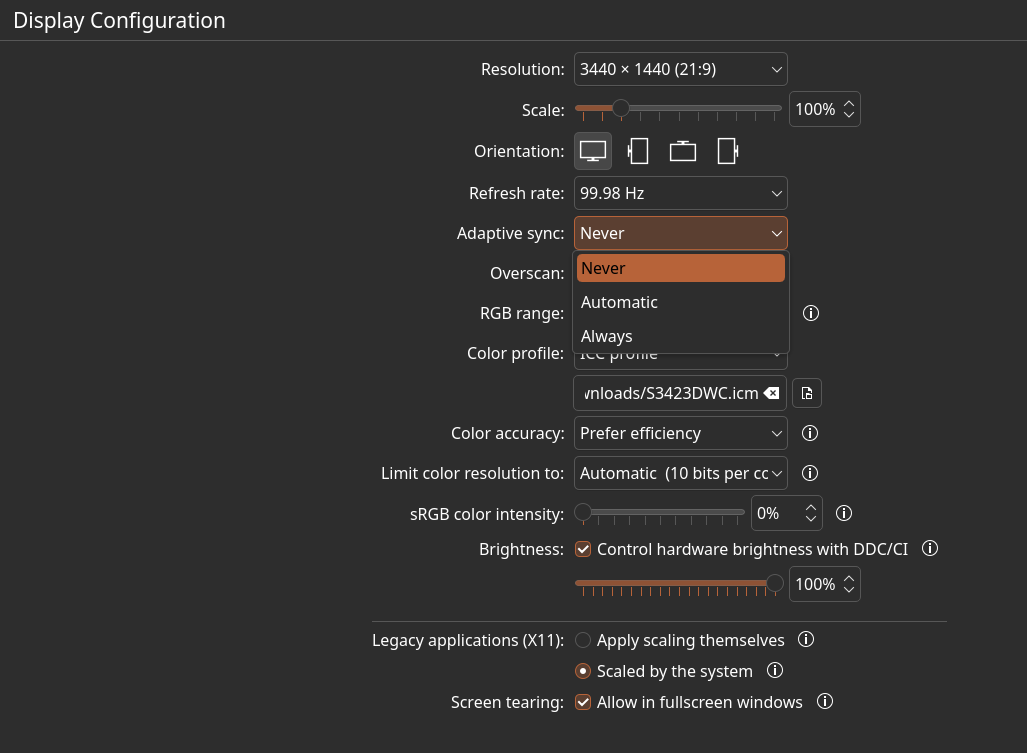

But which settings do you have enabled for your display ? Is adaptive sync activated eventually ? If so, I’ld recommend to deactivate it. I’ve got totally different hardware, but adaptive sync didn’t really worked for me and resulted in similiar glitches. No issues since I’ve deactivated it in my case.
Yeah adaptive sync is set to never, aka disabled
