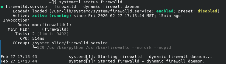

firewalld started with no problems. Run systemctl status firewalld immediately after boot up while firewalld is is still not ative, and you should get the above results. Namely “enabled” listed above in green letters, “active (running)” listed above in green letters

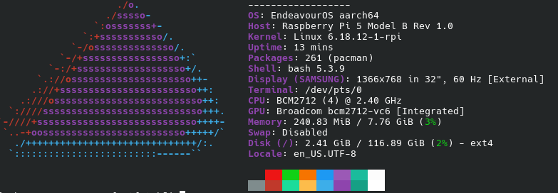

Notice Packages: 261 (pacman) and Memory: 240.83 MiB
This is really a base install.

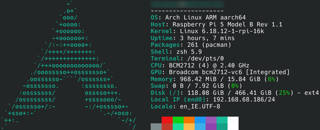

I used an SD image EnOS to put Arch on a PCIe SSD. It’s a pretty minimal install. I actually have the exact same number of packages as you do:

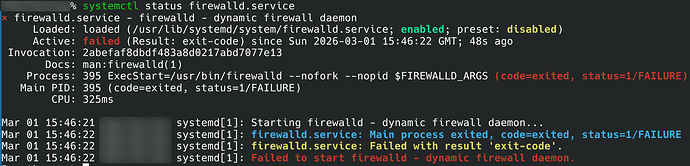

I get the following output from systemctl status firewalld.service immediately after boot:

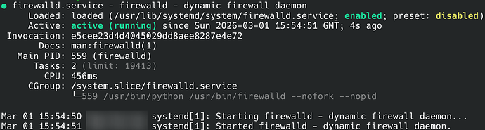

Then, magically after running sudo systemctl restart firewalld.service:

The only differences I see are from your systemctl print outs.
Right after boot up and firewalld not running
Process: 395 ExecStart=/usr/bin/firewalld --nofork --nopid $FIREWALLD_ARGS
after executing systemctl restart firewalld.service
CGroup: /system.slice/firewalld.service
               |_559 /usr/bin/python /usr/bin/firewalld --nofork --noip
