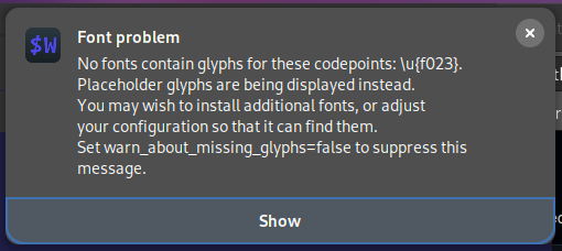

I recently took a liking to an application called WezTerm. One interesting thing came up when I tried to use yay to update my system. The terminal warned me that it was missing the ability to display some character with:
Screenshot from 2023-10-01 13-39-17
I read the wezterm documentation here when pressing “Show” which explains that by default it only uses:

The problem is that even with these 2 extra fonts, I still get the warning. So I looked up the character and found this information in codepoints which explains that it is a “private use area” character which means:

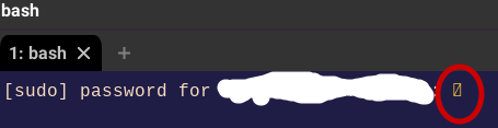

This is what WizTerm displays, I am assuming that the character is the red-circled one?
But, I’m confused now: how do I fix this?
At first I thought it was missing from the fonts used, so I added fonts.
Now, it seems to be the case that yay is using a “private character” that is non standard when prompting for a password?
Just find this interesting and would appreciate other people’s take on this. Anyone using WezTerm? What did you do about this, just ignore the warning?

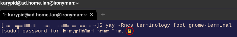

I was able to sort this out with the developer in a github discussion. It’s actually an interesting story and you can read about it on github, but the executive summary is:
  1. wezterm warning is correct, there is indeed a PUA character being used and not shown, because I am missing font for it
  2. In my system, the “nerd font symbols” and “noto color emoji” fonts were missing ; other terminals (foot, gnome terminal, terminology) were simply silently not showing anything
  3. After installing the nerd symbols font I was able to see the output properly which looks like this:
