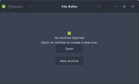

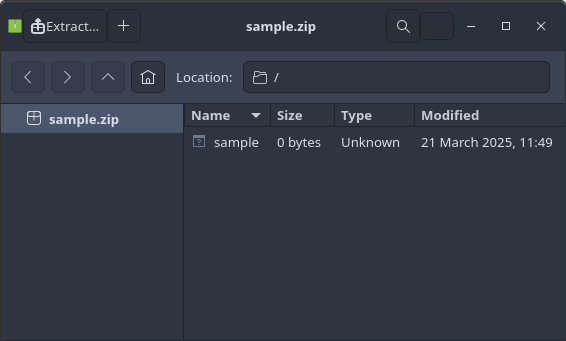

What I chose to do for applying the theme to File Roller (& I’m sure someone will let me know if it’s a bad idea, “the more you know” :wink: ) is to edit the FileRoller.desktop file to specify the theme to use when calling File Roller (might be overwritten during updates?):
sudo nano /usr/share/applications/FileRoller.desktop
Change:
Exec="file-roller %U"
To:
Exec=bash -c "GTK_THEME=your-preferred-theme-name file-roller %U"
I later changed this to use a $(command) substitution querying the current GTK theme so that it always matches even if I change my theme (until it breaks :rofl:) & consequently should also work for multi-user systems where each user may have a different theme:
Exec=bash -c "GTK_THEME=$(gsettings get org.gnome.desktop.interface gtk-theme | tr -d \\"'\\") file-roller %U"
The theme query result wraps the current theme name in single quotes (‘your-preferred-theme-name’) so the command substitution includes piping the result to tr to remove the single quote characters, this required escaping the " in the command with \ which itself required escaping hence \\"'\\".

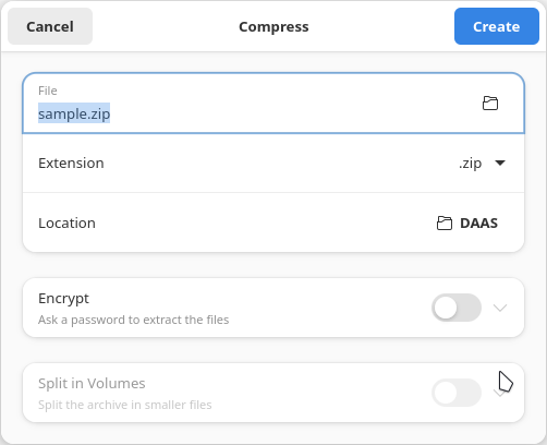

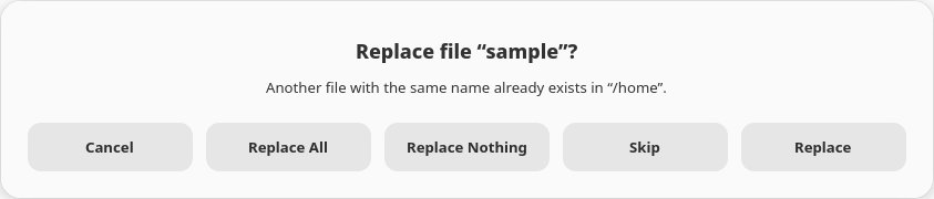

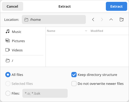

I works when launching File Roller directly or when opening an archive file associated with File Roller:
But not when invoking an archive/extract action from context menus (maybe some other app is used then instead?):
Hope this helps others. Please contribute if you know how to alter the theme for compress/extract actions.
