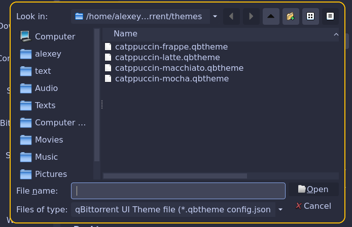

I’ve got several boxes, similar installations with two desktops: Plasma KDE and DMS niri. I live my life mostly on niri. On one box qBittorrent uses normal (big, functional, and pretty) KDE file dialog on Plasma and GTK file chooser on niri. This is acceptable. On another box I see something else:
This is probably a KDE dialog, but from a second hand store. The same with Okular, so the setting is system wide. How to change it for something decent?

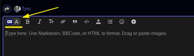

PS Is there a way to turn off the markdown helper, or whatever it is? Once I new just how and where to put a triple backtick and things, now I’m as helpless as on Reddit

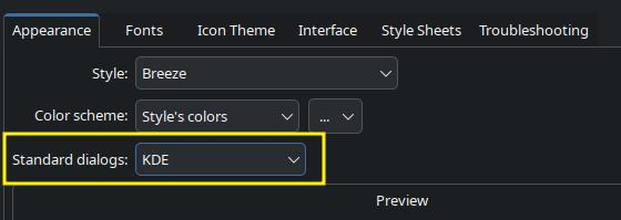

According to Arch Wiki, qt5ct-kde and qt6ct-kde packages are nicer, especially when used outside KDE. They offer better choice, and enforce it somewhat better, indeed. But the whole ecosystem is fragile and way too complicated
