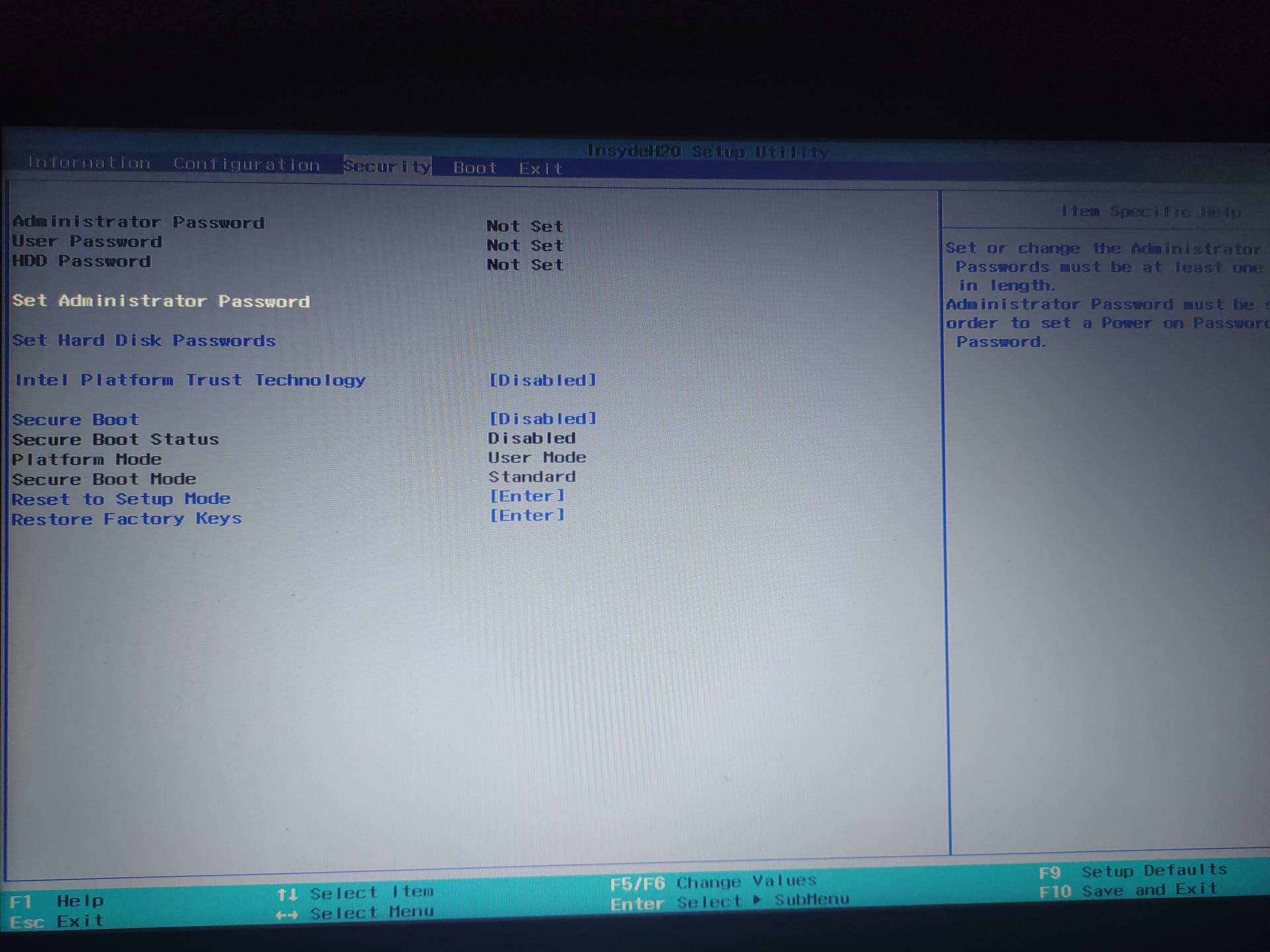

This look like secure boot is enabled. It should be disabled.
Edit:
I have it like this:
Not sure why it’s showing this info in the output then.
Edit: How are you creating the boot media? Are you able to try another usb drive? Also maybe wipe the internal drive with gparted using the live ISO. You can do this by creating a new GPT partition.
