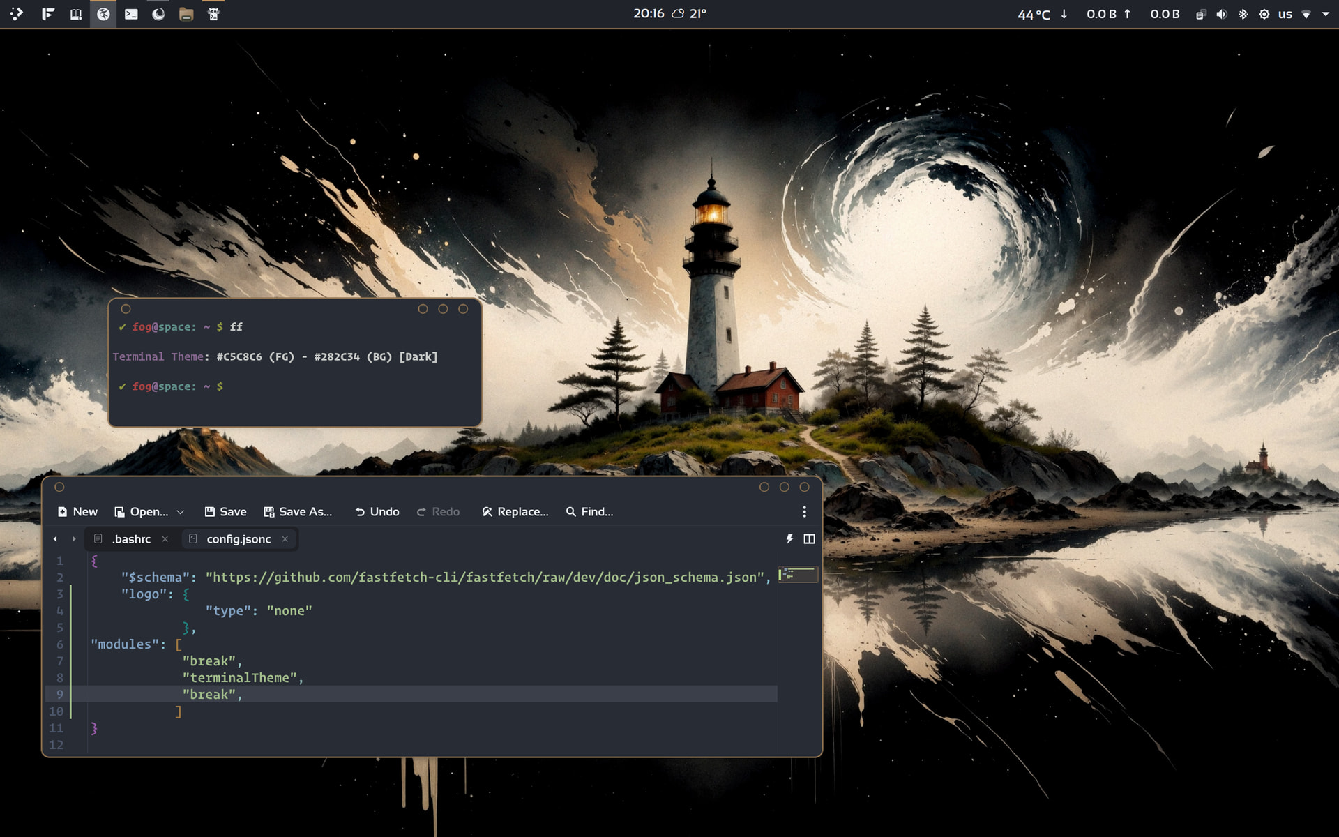

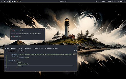

The only module about the terminal theme I found, is the… “terminaltheme”
Maybe I missed something, here is the json_schema.json with all the modules.
With “terminaltheme” module this is the result:

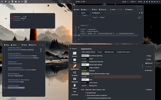

@fog, thank you for your efforts. It doesn’t seem to work the way I would like it to. It should automatically display the color scheme used in the console. It looks like fastfetch only outputs the color output but not the color theme used. Too bad, but thanks for your efforts anyway.
IF your ~/.config/konsolerc has the right name for the colorscheme then maybe this code doing the job. I don’t do checks for spaces, it’s not an elegant code but in my setup works :stuck_out_tongue:
  "type": "command",
  "key": "ColorScheme",
  "text": "grep -oP '^ColorScheme=\\K.*' ~/.config/konsolerc"
That, my dear @fog, is fantastic. I would never have thought of that. See how simple-minded I am :winking_face_with_tongue:
It really works. I don’t really understand it, but it works. I can still manage the grep command, but everything that comes after that is too much for me.
grep: now we are searching
-o: (only …matching) we want only the matched part of the line, not the entire line
-P: enables advanced perl regular expressions because we want the best :stuck_out_tongue:
^ColorScheme= : matches/finds the string ColorScheme= at the beginning of a line (^)
\K: You found it? Now forget it, we don’t want it in the final output. :zany_face:
.* : Found/match the characters after ColorScheme= , hopefully this is the name of the color scheme.
~/.config/konsolerc: the path to the konsole configuration file where the color scheme is stored and the magic happens :face_with_spiral_eyes:
Holy blimmin’ moly :nerd_face:
Thank you for taking the time to explain all this to me. I understand as far as I can. But you know what? Unlike many others, I am, figuratively speaking, moving on the surface of the water. You are 50 meters below. Others are 100 meters below… I think it’s futile to believe that I can remember all this. Fortunately, there’s the bookmark function :winking_face_with_tongue: And users like you who explain it all to me :heart_hands:
I used the copy function in the Discourse and then wl-paste > ffconfig.jsonc, so there shouldn’t be a forgotten bracket. Maybe my mapping of the emojis to the normal font is broken.
Thanks for showing this “keep” option, I would have piped cut or something else.

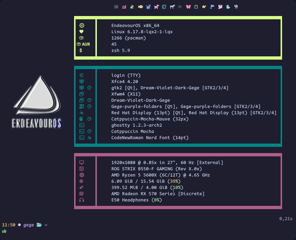

For Ghostty terminal, it looks like this :
"text": "grep -oP '^theme = \\K.*' ~/.config/ghostty/config",

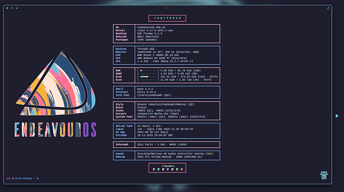

  • Split theme entry to separate Qt and GTK themes (thanks for the tip @dirn and @fog)
  • Widened the entire border a bit.
  • Centered box-headings better.
  • New image.
A couple of tweaks and additions. :steaming_bowl:
This is the thread that just keeps giving. Thanks everyone. :victory_hand:

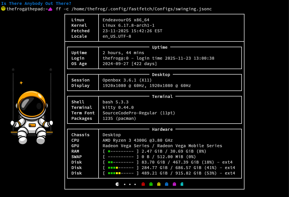

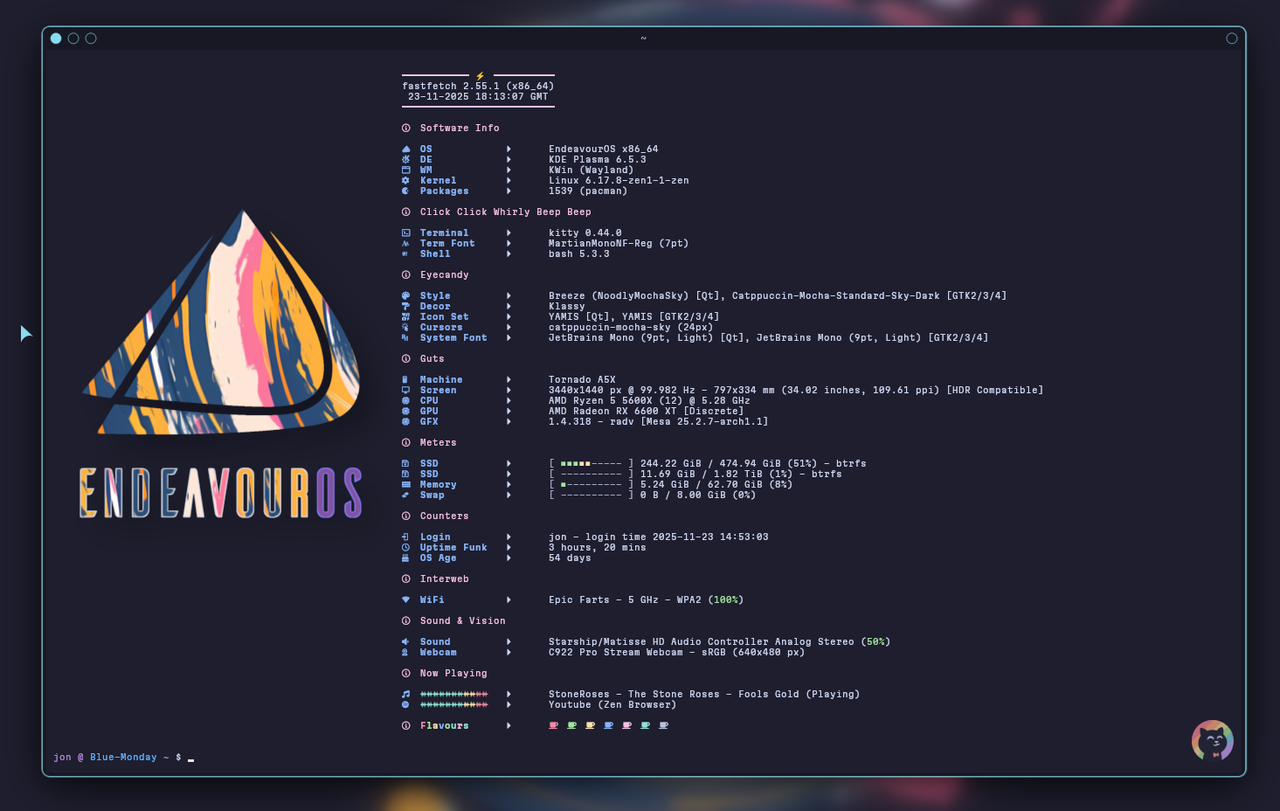

My FF Config
//  Inspired by many and cobbled together by Noodly
    "$schema": "https://github.com/fastfetch-cli/fastfetch/raw/dev/doc/json_schema.json",
     "logo": {
        "type": "auto",
        "source":  "/home/jon/Pictures/EnOS Fastfetch Logos/EnOS Noodly Logo Paint.png",
        "height": 38,
        "padding": {
          "top": 12,
          "left": 1,
          "right": 1
    "display": {
        "separator": "         "
    "modules": [
        "break",
            "type": "custom",
            "format": "\u001b[35m─────────── ⚡ ──────────\u001b[0m"
            "type":  "version",
            "key": " "
            "type": "datetime",
            "key": " ",
            "format": " {day-pretty}-{month-pretty}-{year} {hour-pretty}:{minute-pretty}:{second-pretty} {timezone-name}"
            "type": "custom",
            "format": "\u001b[35m─────────────────────────\u001b[0m"
        "break",
            "type": "custom",
            "format": "\u001b[m{#35}  Software Info\u001b[0m"
        "break",
            "type": "os",
            "key": "  OS         ",
            "keyColor": "34",
            "type": "de",
            "key": "  DE         ",
            "keyColor": "34",
            "type": "wm",
            "key": "  WM         ",
            "keyColor": "34",
            "type": "kernel",
            "key": "  Kernel     ",
            "keyColor": "34",
            "type": "packages",
            "key": "󰮯  Packages   ",
            "keyColor": "34",
        "break",
            "type": "custom",
            "format": "\u001b[m{#35}  Click Click Whirly Beep Beep\u001b[0m"
        "break",
            "type": "terminal",
            "key": "  Terminal   ",
            "keyColor": "34",
            "type": "terminalfont",
            "key": "  Term Font  ",
            "keyColor": "34",
            "type": "shell",
            "key": "󱆃  Shell      ",
            "keyColor": "34",
        "break",
            "type": "custom",
            "format": "\u001b[m{#35}  Eyecandy\u001b[0m"
        "break",
            "type": "theme",
            "key": "  Style      ",
            "keyColor": "34",
            "type": "wmtheme",
            "key": "  Decor      ",
            "keyColor": "34",
            "type": "icons",
            "key": "  Icon Set   ",
            "keyColor": "34",
            "type": "cursor",
            "key": "󰳽  Cursors    ",
            "keyColor": "34",
            "type": "font",
            "key": "󰛖  System Font",
            "keyColor": "34",
        "break",
            "type": "custom",
            "format": "\u001b[m{#35}  Guts\u001b[0m"
        "break",
            "type": "host",
            "key": "󰇅  Machine    ",
            "keyColor": "34",
            "type": "monitor",
            "key": "󰍹  Screen     ",
            "keyColor": "34",
            "type": "cpu",
            "key": "  CPU        ",
            "keyColor": "34",
            "type": "gpu",
            "key": "  GPU        ",
            "keyColor": "34",
            "type": "vulkan",
            "key": "  GFX        ",
            "keyColor": "34",
        "break",
            "type": "custom",
            "format": "\u001b[m{#35}  Meters\u001b[0m"
        "break",
            "type": "disk",
            "keyColor": "34",
            "key": "  SSD        ",
            "percent": {
        "type": 3,           // 3 = show number + bar + percentage
        "green": 30,         // Below 30% usage is green
        "yellow": 70         // 30-70% is yellow, >70% is red
      "bar": {
        "width": 20,         // Number of characters for the bar
        "charElapsed": "■",  // Used bar character
        "charTotal": "-",    // Unused bar character
        "borderLeft": "[",
        "borderRight": "]"
            "type": "memory",
            "key": "  Memory     ",
            "keyColor": "34",
            "percent": {
        "green": 30, // <30% is green
      "bar": {
        "width": 20, // number of characters in the bar
        "charElapsed": "■", // used part of the bar
        "charTotal": "-", // unused part of the bar
        "borderLeft": "[",
        "borderRight": "]"
            "type": "swap",
            "key": "󰯍  Swap       ",
            "keyColor": "34",
             "percent": {
        "type": 3,
        "green": 30,
        "yellow": 70
      "bar": {
        "width": 20,
        "charElapsed": "■",
        "charTotal": "-",
        "borderLeft": "[",
        "borderRight": "]"
        "break",
            "type": "custom",
            "format": "\u001b[m{#35}  Counters\u001b[0m"
        "break",
            "type": "users",
            "myselfOnly": true,
            "key": "󰍂  Login      ",
            "keyColor": "34",
            "type": "uptime",
            "key": "  Uptime Funk",
            "keyColor": "34",
            "type": "command",
            "key": "  OS Age     ",
            "keyColor": "34",
            "text": "birth_install=$(stat -c %W /); current=$(date +%s); time_progression=$((current - birth_install)); days_difference=$((time_progression / 86400)); echo $days_difference days"
        "break",
            "type": "custom",
            "format": "\u001b[m{#35}  Interweb\u001b[0m"
        "break",
            "type": "wifi",
            "key": "󰤨  WiFi       ",
            "keyColor": "34",
            "type": "bluetooth",
            "key": "󰂯  Bluetooth  ",
            "keyColor": "34",
        "break",
            "type": "custom",
            "format": "\u001b[m{#35}  Sound & Vision\u001b[0m"
        "break",
            "type": "sound",
            "key": "  Sound      ",
            "keyColor": "34",
            "type": "camera",
            "key": "󰖠  Webcam     ",
            "keyColor": "34",
        "break",
            "type": "custom",
            "format": "\u001b[m{#35}  Now Playing\u001b[0m"
        "break",
            "type": "media",
            "key": "  {#36}󱑽{#36}󱑽{#36}󱑽{#36}󱑽{#36}󱑽{#36}󱑽{#36}󱑽{#33}󱑽{#33}󱑽{#31}󱑽{#31}󱑽",
            "keyColor": "34",
            "type": "player",
            "key": "󰓇  {#36}󱑽{#36}󱑽{#36}󱑽{#36}󱑽{#36}󱑽{#36}󱑽{#36}󱑽{#33}󱑽{#33}󱑽{#31}󱑽{#31}󱑽",
            "keyColor": "34",
        "break",
            "type": "custom",
            "key": "{#35}  {#31}F{#32}l{#33}a{#34}v{#32}o{#36}u{#35}r{#36}s   ",
            "format":"{#31} {#32}  {#33}  {#34}  {#35}  {#36}  {#37}  "
        "break",
        "break",
Another addition for you
Get it Here
Sooo cuuuuuute :smiley:
that’s what I thought :joy:

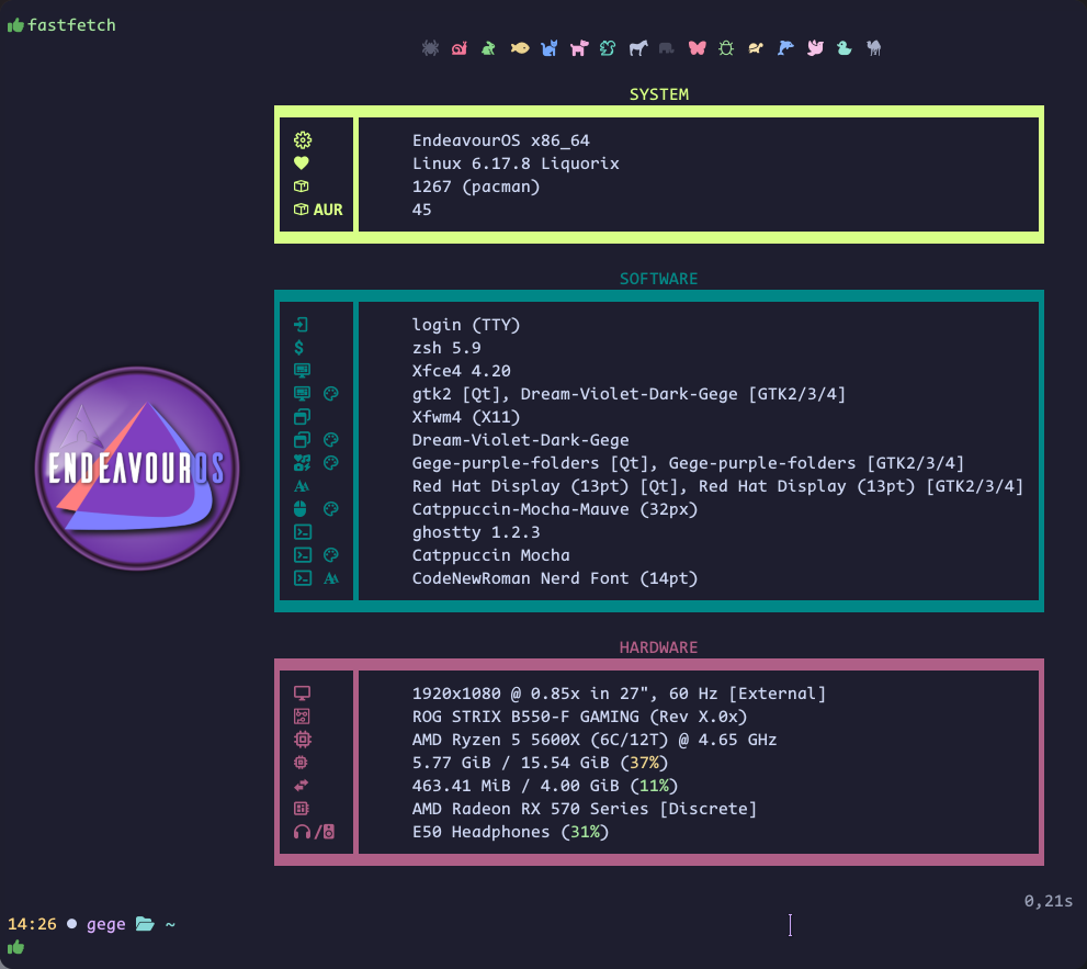

I think I will keep this one, apart changing the logo from time to time.
// ~/.config/fastfetch/config.jsonc
// See https://github.com/fastfetch-cli/fastfetch/wiki/Configuration for more details
// See *.jsonc in https://github.com/fastfetch-cli/fastfetch/tree/dev/presets/examples for more examples
    "logo": {
		"source": "~/.icons/eoslogo200x200.png",
        "type": "auto",
        "color": {"1": "38;5;207"},
        "padding": {
            "top": 14,
            "left": 2,
            "right": 2,
     "display": {
        "color": "38;5;132",
        "separator": "   ",
        "constants": ["\u001b[66C \u001b[38;5;192m▐\u001b[67D",
                      "\u001b[66C \u001b[38;5;030m▐\u001b[67D",
					  "\u001b[66C \u001b[38;5;132m▐\u001b[67D",
    "modules": [
		"break",
            "type": "custom",
            "format": "               \u001b[90m  \u001b[91m󱙷  \u001b[92m󰤇  \u001b[93m  \u001b[94m  \u001b[95m  \u001b[96m  \u001b[97m  \u001b[30m󰟆  \u001b[31m  \u001b[32m  \u001b[33m󰴻  \u001b[34m󱢴  \u001b[35m  \u001b[36m󰇥  \u001b[37m \u001b[0m",
        "break",
            "type": "custom",
            "format": "\u001b[38;5;192m                                    SYSTEM",
            "type": "custom",
            "format": "\u001b[38;5;192m▛▀▀▀▀▀▀▀▛▀▀▀▀▀▀▀▀▀▀▀▀▀▀▀▀▀▀▀▀▀▀▀▀▀▀▀▀▀▀▀▀▀▀▀▀▀▀▀▀▀▀▀▀▀▀▀▀▀▀▀▀▀▀▀▀▀▀▀▀▀▀▀▀▀▀▀▀▜\u001b[0m"
        "type": "os",
        "key": "▌      ▌ {$1}",
        "keyColor": "38;5;192",
        "type": "kernel",
        "key": "▌ 󰋑     ▌ {$1}",
        "format": "{sysname} {release:6} Liquorix",
        "type": "packages",
        "key": "▌      ▌ {$1}",
        "type": "command",
        "key": "▌  AUR ▌ {$1}",
        "text": "yay -Qqm | wc -l"
            "type": "custom",
            "format": "\u001b[38;5;192m▙▄▄▄▄▄▄▄▙▄▄▄▄▄▄▄▄▄▄▄▄▄▄▄▄▄▄▄▄▄▄▄▄▄▄▄▄▄▄▄▄▄▄▄▄▄▄▄▄▄▄▄▄▄▄▄▄▄▄▄▄▄▄▄▄▄▄▄▄▄▄▄▄▄▄▄▄▟\u001b[0m"
        "break",
            "type": "custom",
            "format": "\u001b[38;5;030m                                   SOFTWARE",
            "type": "custom",
            "format": "\u001b[38;5;030m▛▀▀▀▀▀▀▀▛▀▀▀▀▀▀▀▀▀▀▀▀▀▀▀▀▀▀▀▀▀▀▀▀▀▀▀▀▀▀▀▀▀▀▀▀▀▀▀▀▀▀▀▀▀▀▀▀▀▀▀▀▀▀▀▀▀▀▀▀▀▀▀▀▀▀▀▀▜\u001b[0m"
        "type": "LM",
        "key": "▌ 󰍂     ▌ {$2}",
        "keyColor": "38;5;030",
        "type": "shell",
        "key": "▌      ▌ {$2}",
        "type": "de",
        "key": "▌ 󰨇     ▌ {$2}",
        "type": "theme",
        "key": "▌ 󰨇  󰸌  ▌ {$2}",
        "type": "wm",
        "key": "▌      ▌ {$2}",
        "type": "wmtheme",
        "key": "▌   󰸌  ▌ {$2}",
        "type": "icons",
        "key": "▌   󰸌  ▌ {$2}",
        "type": "font",
        "key": "▌      ▌ {$2}",
        "type": "cursor",
        "key": "▌ 󰍽  󰸌  ▌ {$2}",
        "type": "terminal",
        "format": "{pretty-name} {version:5}",
        "key": "▌      ▌ {$2}",
        "type": "command",
        "key": "▌   󰸌  ▌ {$2}",
        "key": "▌     ▌ {$2}",
            "type": "custom",
            "format": "\u001b[38;5;030m▙▄▄▄▄▄▄▄▙▄▄▄▄▄▄▄▄▄▄▄▄▄▄▄▄▄▄▄▄▄▄▄▄▄▄▄▄▄▄▄▄▄▄▄▄▄▄▄▄▄▄▄▄▄▄▄▄▄▄▄▄▄▄▄▄▄▄▄▄▄▄▄▄▄▄▄▄▟\u001b[0m"
        "break",
            "type": "custom",
            "format": "\u001b[38;5;132m                                   HARDWARE",
            "type": "custom",
            "format": "\u001b[38;5;132m▛▀▀▀▀▀▀▀▛▀▀▀▀▀▀▀▀▀▀▀▀▀▀▀▀▀▀▀▀▀▀▀▀▀▀▀▀▀▀▀▀▀▀▀▀▀▀▀▀▀▀▀▀▀▀▀▀▀▀▀▀▀▀▀▀▀▀▀▀▀▀▀▀▀▀▀▀▜\u001b[0m"
        "type": "display",
        "key": "▌ 󰍹     ▌ {$3}",
        "keyColor": "38;5;132",
        "type": "board",
        "key": "▌      ▌ {$3}",
        "type": "cpu",
        "format": "{name} ({cores-physical}C/{cores-logical}T) @ {freq-max}",
        "key": "▌      ▌ {$3}",
        "type": "memory",
        "key": "▌ 󰍛     ▌ {$3}",

Those animal icons are cute :kissing_face_with_smiling_eyes:
Tweaked colors and image…
I forgot to start my USB DAC, so the system switched to HDMI audio and… surprise !
soundnottrunc
I had to truncate the line to 54 characters.
"type": "sound",
        "format": "{name:54} ({3})",
        "key": "▌  /󰓃  ▌ {$3}",
soundtrunc
giphy
Here’s what I’ve come up with thanks to what I’ve learned from the amazing contributions to this thread.
My Fastfetch Config
