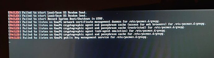

Failed to start Load/Save random OS seed
Hello there,
unfortunately, I managed to break my installation…
What I did:
I updated the prusaslicer package via Flatpak and the steam client at the same time. At least the Flatpak update didn’t finish successfully, and the computer completely froze during the process.
(I thought Flatpak and the steam client are somehow encapsulated, as no pacman/yay was involved.)
After a reboot, I got the following error messages:
I have an encrypted system with btrfs, but unfortunately, every old snapshot produces the same error message.
I can access my system using a live USB stick and arch-chroot.
But where/how should I begin fixing this error?
Thanks and happy holidays! :christmas_tree:
