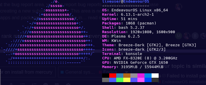

neofetch output

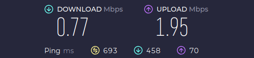

what says speedtesting the connection?
using ookla or something
offline install worked, sorry for the trouble. I’ll probably make a new post about powerline adaptors.
websites take nearly a minute minimum to load so its a network issue
as suspected its an internet issue
speed is something else… thats non existing connection

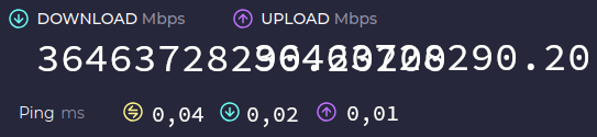

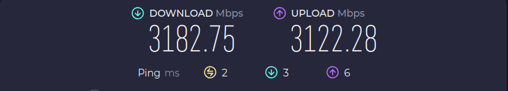

I’m gonna start reporting him if he posts that speed test result again, because I’m jealous! :wink:
It’s actually a little slow. I want to be able to jump two dimensions not just one. :rofl:
Oh you’re measuring Mbps, not Tbps… :wink:
