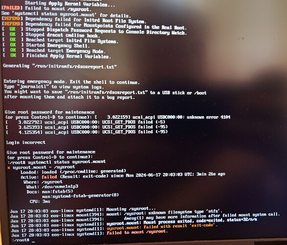

I have installed EndeavourOS and facing the boot issue. It’s not constant and resolves after 3rd-5th reboot, however very frustrating.
systemctl status sysroot.mount shows that the root cause is /dev/nvme1n1p3 that is nothing but a Windows OS system partition. Not sure why it’s trying to mount it as there are no other records in fstab but defaults, so no NTFS partitions.

dracut-rebuild didn’t help. However, I think I got the reason. I executed the same fdisk -l on Manjaro and got different device identifications (nvme0n1 and nvme1n1). They just swapped. As I did update-grub after the EOS installation from Manjaro, it actually created the wrong (according to EOS fdisk output) GRUB entry:

Are those identifications not persistent from boot to boot? Do you have any ideas on what can be done in this situation?
Have disabled os-prober and added EOS grub record manually with UUID instead of device identifier. Works like a charm. @joekamprad@dalto thank you guys for help. Learned something new today.
