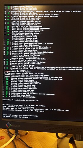

Failed to mount /sysroot during boot
Hi, seems this bug is still sleeping here :frowning:
Did a full update yesterday on my main machine (pacman only) and then tried to boot the lts-kernel.
It’s installed from ISO version 2025.03.19
Same problem as described in the thread here. Has been before the same.
dracut --version → dracut 108.
Tried to use the fallback initrd - no success.
dracut-rebuild - no success.
Hard reset is the only option here.
No more ideas now…
P.S. Searched around in lsinitrd, found a module ext4.ko.zst - seems to be another prob :frowning:
P.S.-2: The errormessage above misses a ‘dm_mod’ module, but I found a dm-mod.ko.zst ???
Edit3: in /usr/lib/dracut/modules.d/70dm/module-setup.sh I found this:
installkernel() {
    hostonly=$(optional_hostonly) instmods '=drivers/md' dm_mod dm-cache dm-cache-mq dm-cache-cleaner
But why does it work on default-kernel?

    cannot boot the lts-kernel. See the picture.

Perhaps you could get that file. It may reveal something interesting.
The only thing I can do here is a cold reboot / switch off.
No input possible.
And on my disk I will find nothing, I think, because /run is in RAM located…
You should be able to enter the password. It will look like nothing is happening.
Normally you could give your root password at that prompt to get into a root shell.
If you say no input is possible, I don’t know why.
Thats what I expected, too. Nope.
Will try the password once again…
Edit: No password, no CTRL-D accepted. Dead.
Edit2: Don’t know, if it will matter: I’m using efi-stub for booting (rEFInd), no grub or systemd.
But, as already said - default-kernel has no problem…
