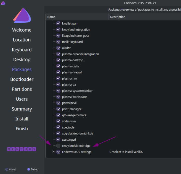

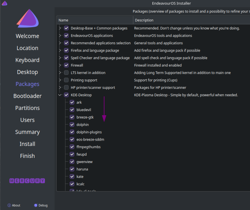

sry for the inconvenience, i will go to HotFix, if you want to install at the very moment, go untag the package from the kde list inside packages screen on installer:
The tip worked, and the install was able to proceed as normal. Many thanks!
