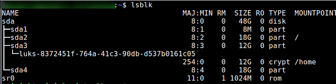

Today I tried but failed to convert my single-boot [GPT+BIOS] Debian laptop with separate LUKS-home partition, into dual-boot with the new EOS root partition sharing that same existing LUKS-home partition. My problem is that EOS’ Calamares did not ask for my existing LUKS-home password. I know how to create a new LUKS-home partition, for which Calamares does prompt for my desired password, but that involves formatting the partition - that’s undesirable here in a situation necessitating using an existing partition containing data.
I’d told it to not format, but only to mount, that partition as my /home, & afaik it should have then prompted me for my password. I chose to continue in hope that maybe later it might do so, but it never did. Sure enough after reboot, I got the EOS boot menu, but from there it waits & waits & waits after mounting the new EOS root partition, but never asks me for my home partition LUKS password [logically because it never solicited it from me during installation], hence eventually lands me in a rescue screen.
In order to experiment more freely, I’ve temporarily put the laptop aside, & created a new VM in my other pc, pretty closely mimicking the laptop partition table arrangement. Sadly, I have reached the same unsuccessful outcome.
Following is my VM’s partition info [as seen from within the Debian boot], then some VM EOS Calamares pictures. My assumption is that if I can solve this for the VM, I should then be able to apply that same method to my laptop

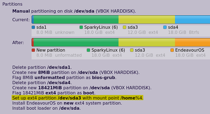

I had a strong clue that it was going to succeed this time, long before the end, because I noticed a subtle, yet I thought significant change. Yesterday, with my LUKS-home Closed, the Calamares post-setup pre-install Summary said it was going to do:
Otoh today, with my LUKS-home Open, the Summary said:
To my delight, this time, once Calamares was finished & I rebooted [both VM, then later laptop], after the grub boot menu I was prompted for my LUKS password, which was accepted & thereafter I reached SDDM thence my new Plasma desktop. Excellent.
