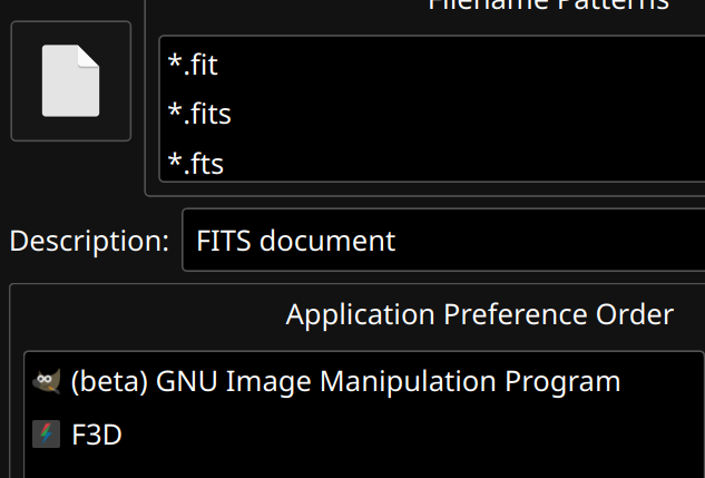

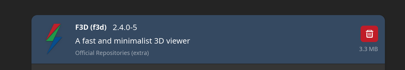

I installed this:

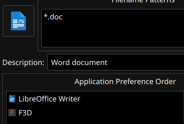

The problem is that somehow, it is associated with EVERY file type. When right-clicking a hidden file on SMB share, F3D is set as the default app. “F3D” has been added for all file type entries. Like hundreds of them. So, it’s not possible to remove F3D. See below. It’s just two examples, but F3D is in EVERY file type in Settings → Default Applications → File Associations.
How to remove F3D from all the unrelated file extensions? It’s a 3D data viewer, so it should only be associated with 3D files.
