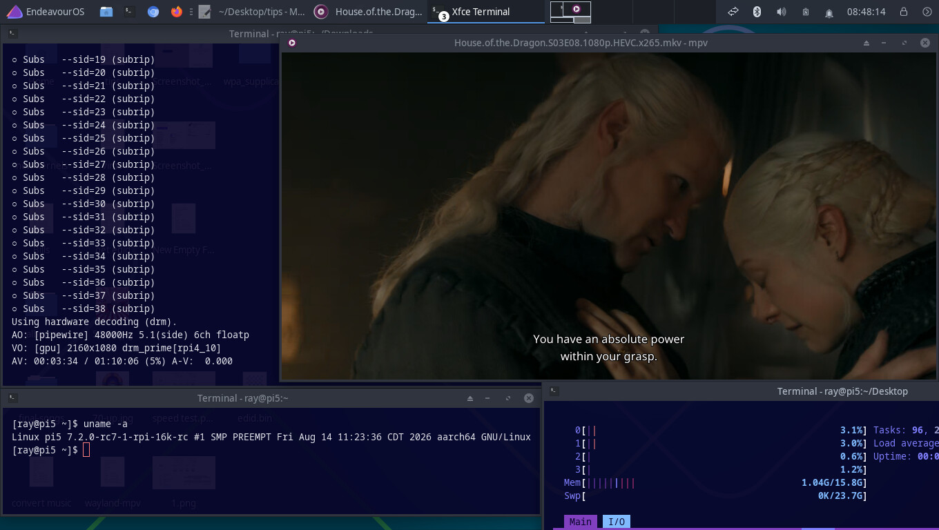

Regarding the hardware acceleration: Raspberry Pi are using V4L2_request like tons of other SBCs, right?
Megi (of RK3399 and RK3566 fame on Pine64 device) has written a wrapper for VA-API, that targets mostly RK3399 (Pinebook Pro and Pinephone Pro) and RK3588 (Orange Pi) but maybe it could be usable for other V4L2_request devices?
Regarding Waydroid: Cool that you managed to get it working! (I did play a bit with it on my Pinephone Pro a long time ago).

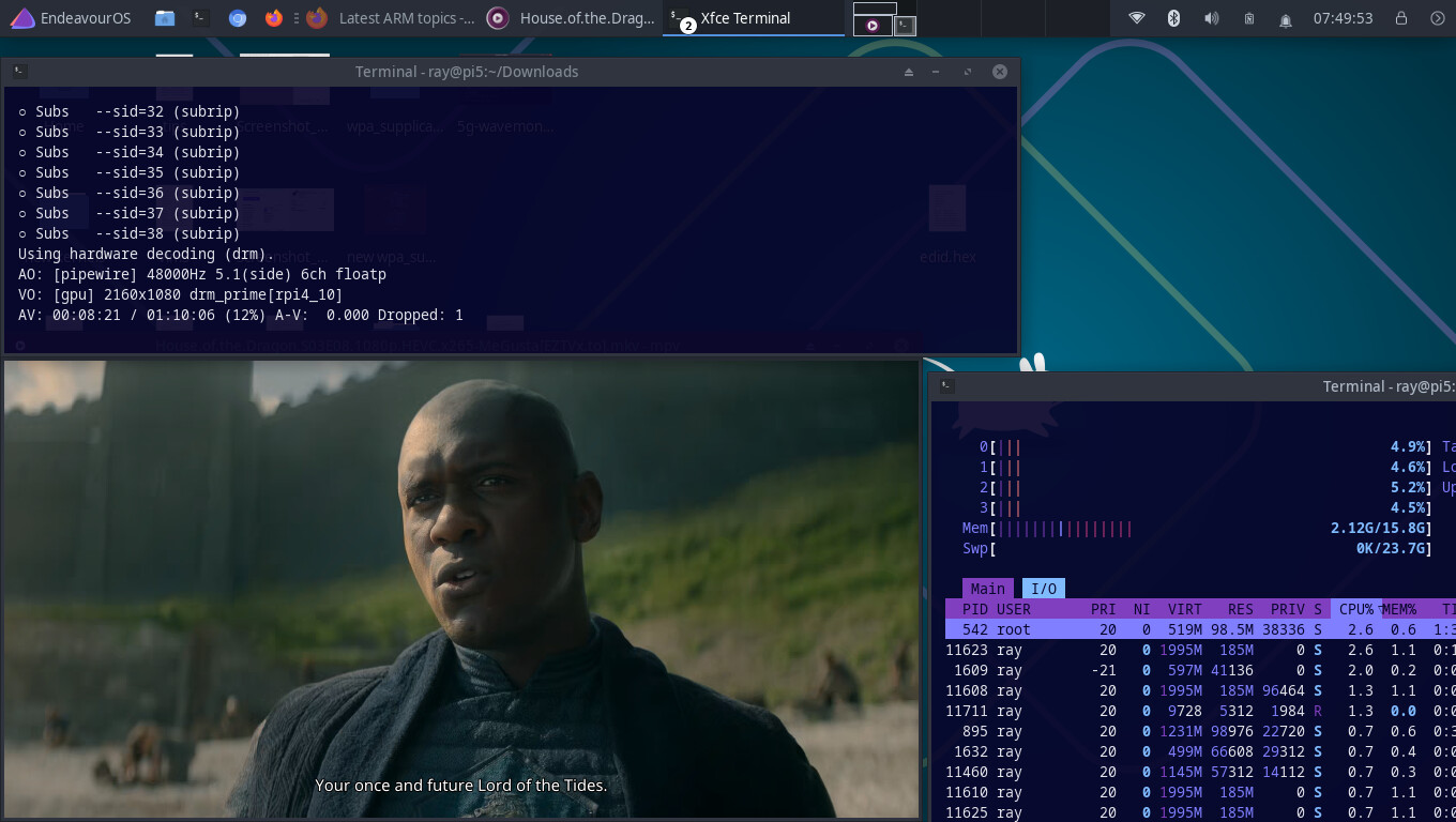

Correct but h265 HW decoding is broke right now on the rpi and according to @tartanpion is due to mesa. I wonder if it affects other devices also…
Interesting. I built it here on my pi4 just to test and looks like it does not want to work for this device but does show some vainfo:

Looks like the kernel also has to be patched for x265 10bit. Speaking of. I wonder what kernel he is using. In the past the mainline kernel had limited support for rockchip HW decoding. It had to be one of their kernels they supported.
My pi kernels are now at 7.1.6.
[ray@pi4 ~]$ uname -a
Linux pi4 7.1.6-1-rpi #1 SMP PREEMPT Tue Aug 4 06:17:37 CDT 2026 aarch64 GNU/Linux
Indeed, that’s possible given that Megi is the dev that makes the kernel with the necessary patches to support Pinebook Pro and Pinephone Pro. Most of these are getting upstreamed, but maybe the HW decoding bits are still living on Megi’s own git?

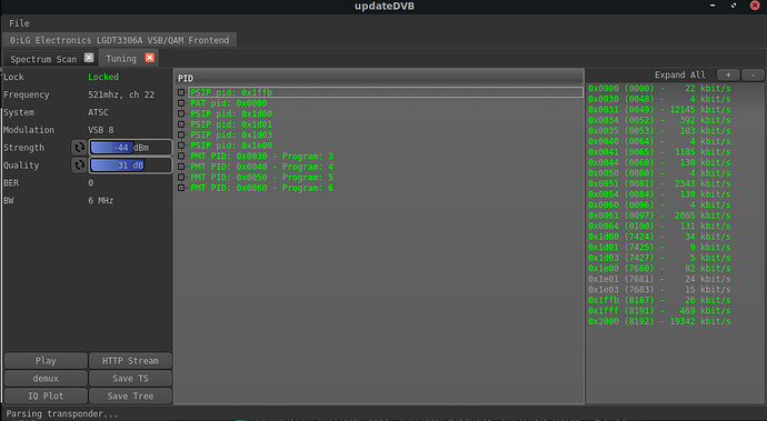

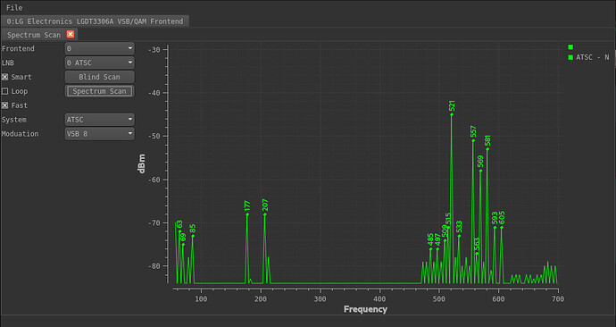

Is there any interest here with satellite and atsc tuners not in the current kernels? A friend is in the process of porting custom modules for various tuners not in the kernel we abandoned a few years back before my heart attack from kernel 5.15 → 7.2 for the rpi devices.
Tested with:
Some prof devices should work Some TBS devices work Skystar 2 eXpress HD Genpix Skywalker-1 Hauppauge 950Q & 955Q Some usb InDtube ATSC devices work pretty good Others are reported working as well.
https://gitlab.com/Dark-Sky/rpi-linux-udl/
https://gitlab.com/majortom9/media-udl/
I can can build the kernels for here when the kernels get ported. Which will probably be around the time kernel 7.2 gets out of the -rc stage.
A couple of pics with Spectrum scan and Tuning lock using another custom program called updateDVB.
