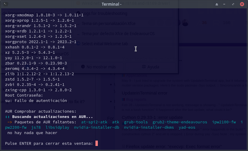

Hi!!! I am new using this and I would like to know if someone can help me please.
I’m trying to update and it gives me the following error, does anyone know how to fix it?
I also tried the following command lines but at some point it gave me an error and it didn’t end up working.
  • sudo pacman-key --refresh-keys
  • sudo pacman -Syy endeavouros-keyring
  • yay -Syu
Nothing wrong with the first two but the third gives me a problem:
It gives me many more errors than what appears in the image
Someone suggested endeavouros to me since I needed a unix system to use sextractor for astronomical purposes and it didn’t have windows support
I have no experience with anything like this and I really need it to use sextractor and get the information from the fits files. any advice is greatly appreciated!!!

  1. For the issue depicted in your first screenshot:
Those packages were once part of the repositories. They are not anymore. Since they are not in AUR either, the package manager is solely informing you about them.
You could check with pactree -r X (replace X with the name of the package) to make sure nothing in your system is dependent on it. If that is the case, you could remove them.
Also you could use the forum’s search function and look them up for more info.
Example: https://forum.endeavouros.com/search?q=yad-eos

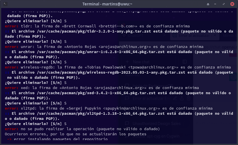

  1. For the issue depicted in your second screenshot:
Install archlinux-keyring first:
sudo pacman -Sy archlinux-keyring
Then try again:
sudo pacman -Syu
