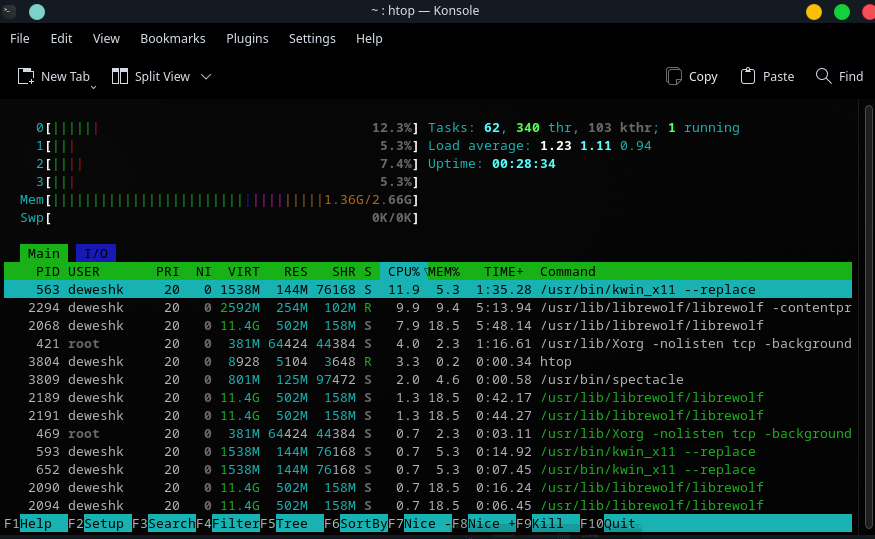

But, on HTOP, the changes are not visible.
What should be the steps that I should follow ?

As you can see, ZRAM is enabled according the aforementioned output, but it is not visible. I had also rebooted the device twice.
