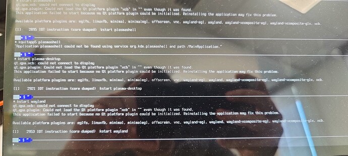

I tried launch KDE Plasma put I get the same error again and again :

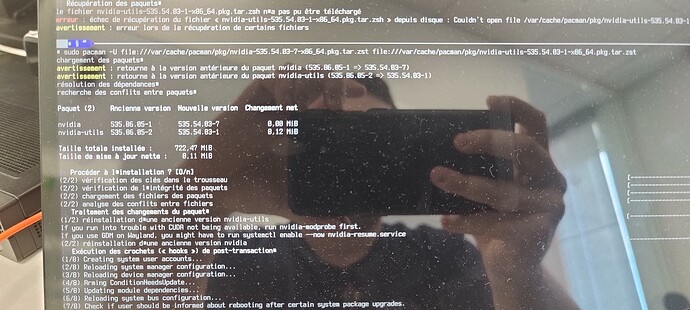

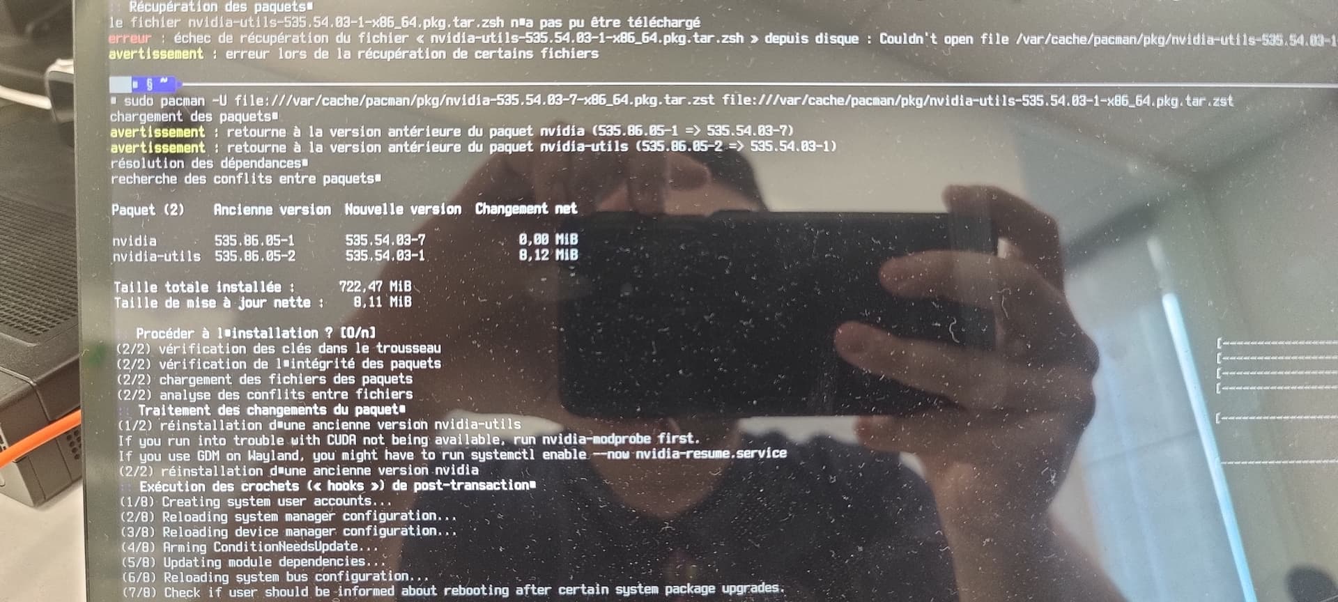

I found the solution doing a rollback for both Nvidia and nvidia-utils :

I tried to rollback nvidia-dkms and nvidia-utils but I get an error
“failed to prepare transaction (could not satisfy dependencies)
installing nvidia-utils (535.54.03-1) breaks dependency ‘nvidia-utils=535.86.05’ required”
