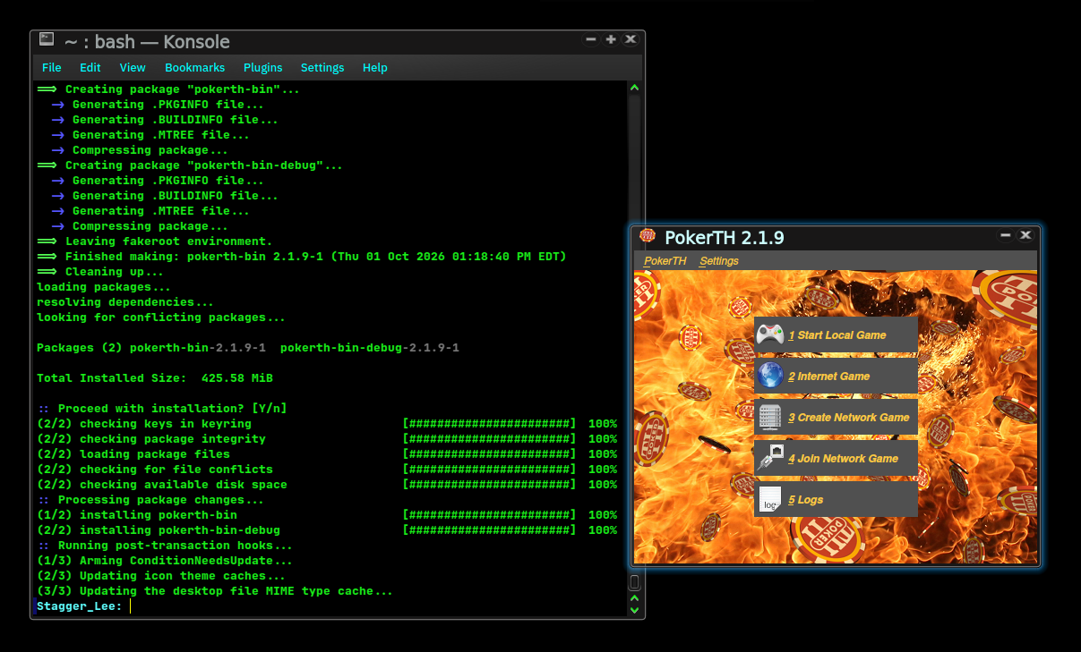

The pokerth-bin package installs (and runs) here (fully updated Arch system) via yay.
I don’t use EndeavourOS but I think they probably disable the debug option in /etc/makepkg.conf (as I have done on my system), but if that option is not disabled you will see a lot of harmless errors during the pokerth-bin package installation.
Can confirm that I could install the bin package as well , on a fully updated EOS system.
