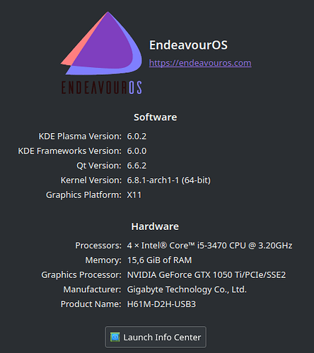

I am using EOS KDE (X11) 6.0 and my pc is i5-3470, gtx1050 ti, 16gb ram.
Kernel? I don’t even know what that is :smiling_face_with_tear: I stopped using Windows less than a year ago and I’m still learning about EOS.
Do you need more information about my PC?
Thanks again friend.
I found this on my system, although I tried to use neofetch from my terminal but it didn’t work, I think EOS does not have neofetch installed:

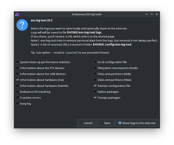

If you bring up the welcome screen you will see a heading for logs for trouble shooting.
EOS like Arch is a DIY distribution except that it provides a graphical installer to give you a minimal start and you do the rest yourself from there. If you don’t even know what a kernel is, you’re better of using Linux Mint for a while until you are more familiarized with Linux and have a grasp on the basic concepts of a Linux distribution.
Run the following in the terminal and share the output: lsblk -f
Thanks friend, but which one should I check and uncheck, so that the hard drive error is recorded?
