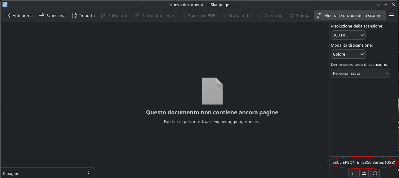

I’ve noticed something strange. I installed the printer drivers (epson-inkjet-printer-escpr) and activated the printer via USB. The printer works, prints, and the scanner is recognized by Skanpage. The scanner works there too.

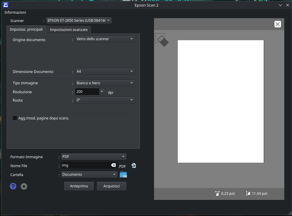

Epsonscan2, however, doesn’t see it, even setting the scanner’s address to inactive.
Usually, once the printer is enabled, Epsonscan2 should detect it normally without any problems.

Here’s what I get on Skanpage:

Yes, I installed the plug-in package along with the epsonscan package. I have both installed.
Solved, guys. All I had to do was unplug and replug the USB port. :sweat_smile:
The mystery remains as to why Skanpage detected it immediately, while Epsoscan2 did not, but that’s okay.
