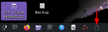

I have also run across a minor bug in Welcome v26.7.1-1 This problem appears with both x86_64 and aarch64 devices using EnOS, KDE Plasma,and Wayland.
I have the Welcome icon on my panel, but welcome v26.7.1-1 does not use the proper welcome icon.
When welcome is launched, it shows the wrong icon then the proper icon.

As a (temporary?) solution you might want to edit this file /usr/share/applications/welcome.desktop
And where it says Icon=/usr/share/endeavouros/endeavouros-icon.avif remove the .avif part.

The file “/usr/share/endeavouros/endeavouros-icon.avif” does not exist. So this needs to be pushed in the next update.
To stop the Welcome application from auto launching + correct the icon I updated the code at /etc/xdg/autostart/welcome.desktop and then copied it to /usr/share/applications/welcome.desktop to sync up the two files.

Just fixed the autostart issue (in welcome 26.7.2-1), hope it works again as expected.
The icon issue may need more research, please test and report! :smiley:
