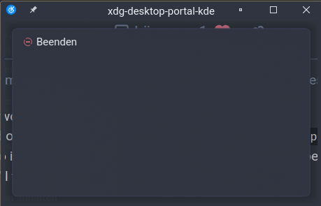

I have reinstalled EOS, but this is new to me.
After displaying eos-update-notifier in the tray, I get this display
After clicking OK I get to the update process
Is there a way to automate this. I mean without having to take the indirect route via remote control?

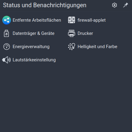

I have found out that it has something to do with xdg-desktop-portal-kde. But I have no idea what it’s all about. However, my knowledge does not go that far. Maybe I’ll find out something
It called in german entfernte Arbeitsflächen, when i click it it goes to xdg-desktop-portal-kde . Dont have a clue

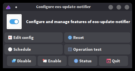

So I did some further testing and I saw that if I click on operation test in the screen from my screenshot, yad will popup. If you click on edit config you will get the yad config file.

EDIT: Notify operation test runs ok but I dont get any systray-icon anymore…

I’ve had to reboot twice today and I’ve just noticed that the icon in the tray has disappeared, as has the indication in the status messages of the remote workspace. This is what i have described in the starting thread but its no longer there

Just tested this in KDE using notify+tray configuration for eos-update-notifier.
  1. Wayland: it gives the same first window like in your first post (access to input devices) and does not update if I refuse the access.
  2. X11: everything works as expected.
That really sounds like a wayland vs. libnotify issue to me.
