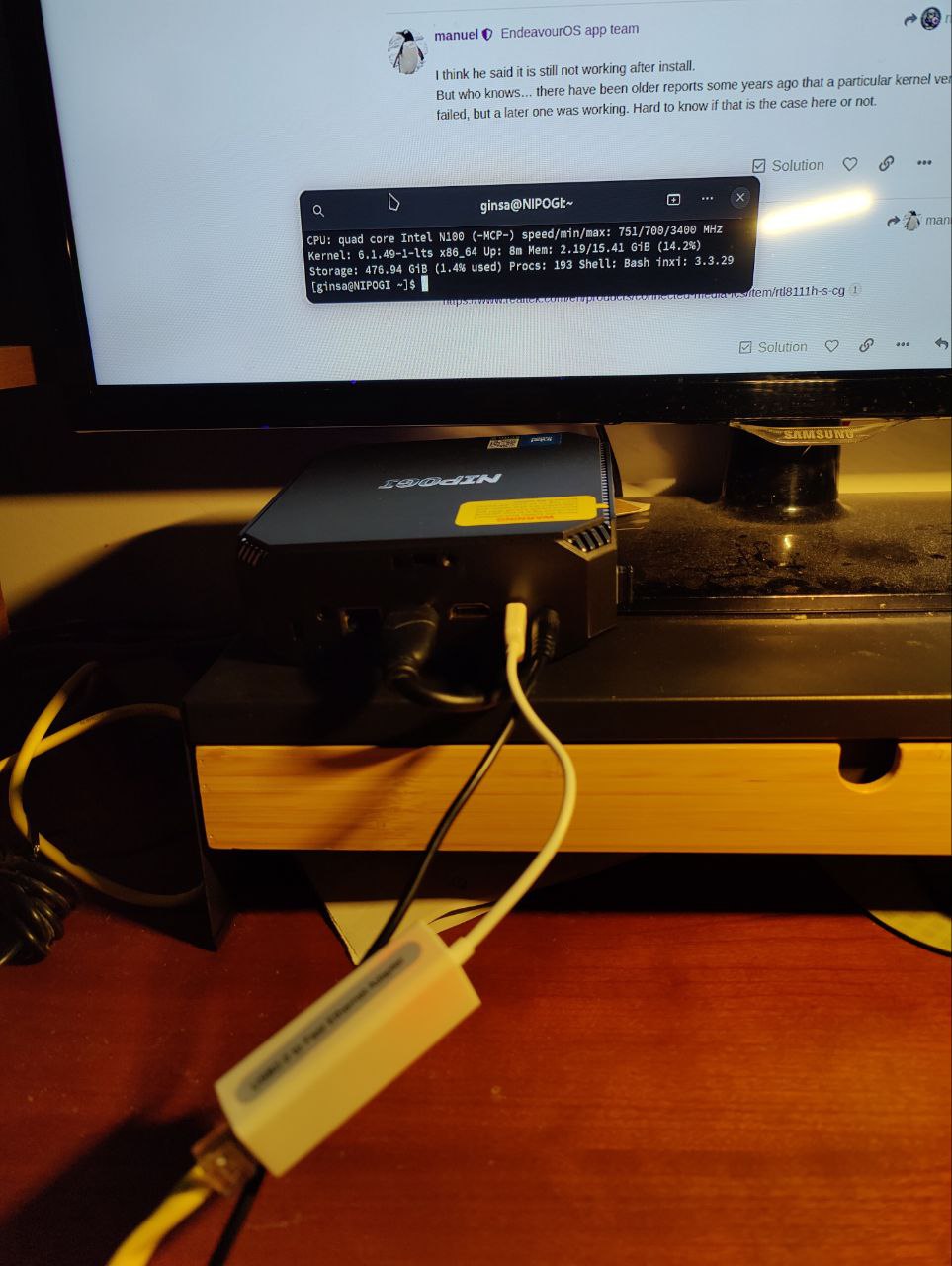

I am tired of wasting my time and making others waste it with a strange hw.
With an ETH → USB adapter it works!
End of my issue. Solved
That is a great solution in this case! :+1:
