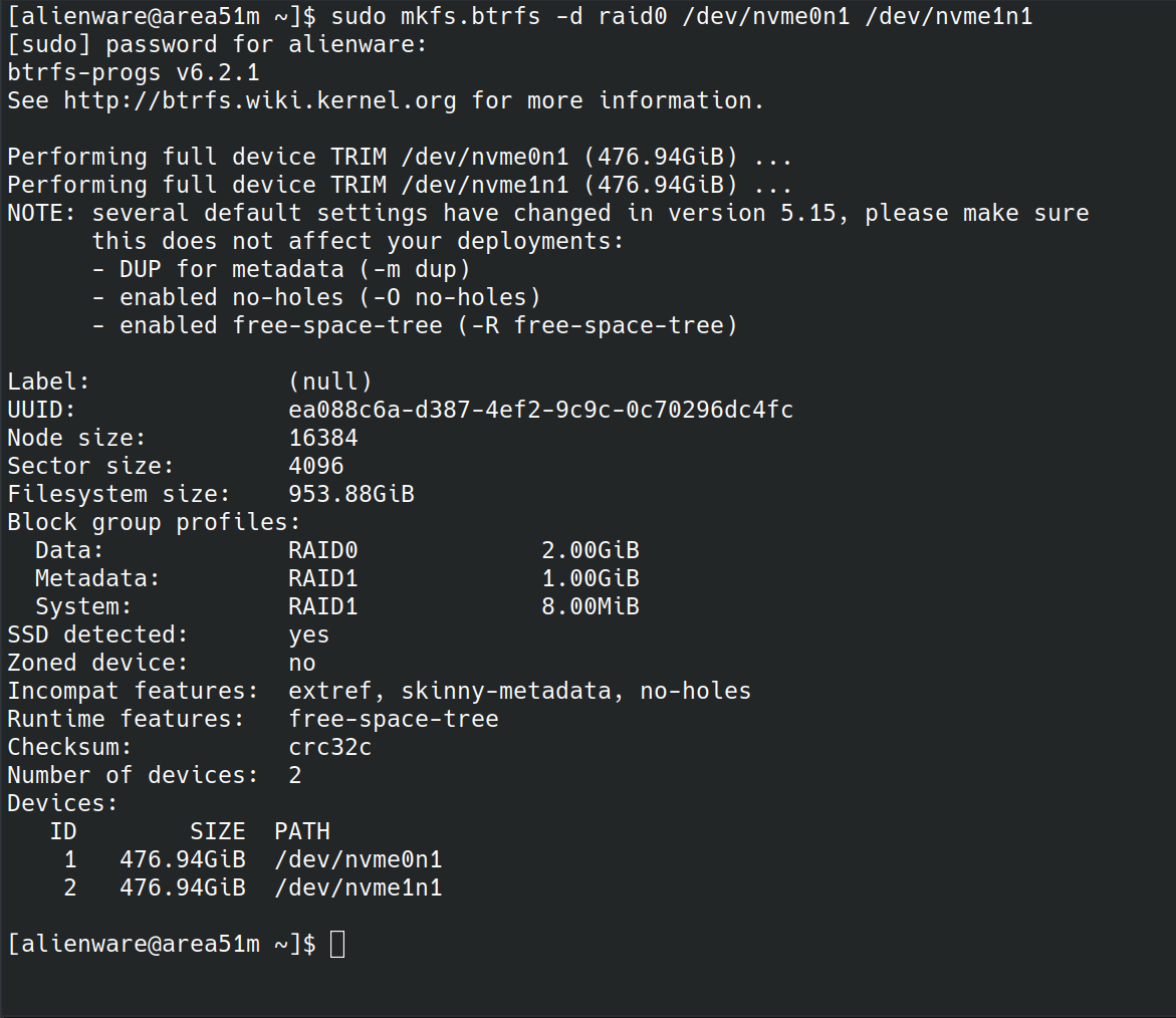

here is my output to use mkfs.btrfs -d raid0 /dev/nvme0n1 /dev/nvme1n1
I cane try to start EOS instalation and again use metod test and error with Calamary to install on this RAID0 array.

Install EndeavourOS on one drive. Then after the installation run mkfs.btrfs -d raid0 /dev/nvme0n1 /dev/nvme1n1
I think this is what @BluishHumility means. :thinking:
Yes, that looks good.
The RAID0 would be set up after the installation. So:
  1. Install EOS on a single disk, no RAID setup so far
  2. Boot to the fresh installation
  3. Add the RAID0 setup as you have above.
That’s it. :slightly_smiling_face:
Yes, exactly. Take the RAID setup out of the installation process altogether. No blivet-gui or anything else, just a normal installation on the one single disk.
