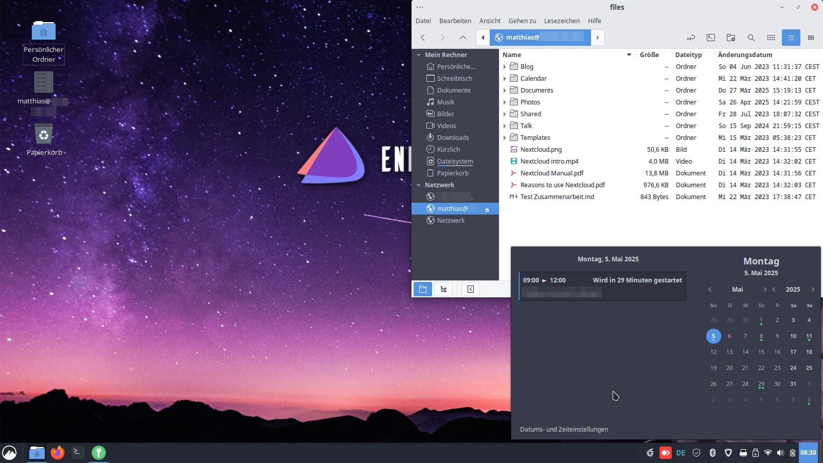

Phew. I decided for EOS w/ Cinnamon, out of pure laziness (been using Mint 12+ years). Considering making this not a plaything, but a machine to work with, I decided to fight this through (and learn new things).
It seems EOS defaults to KDE Plasma for a reason—in retrospect, KDE Plasma seems to be much more well-integrated, and it is much better than it was years ago, when I abandoned it.
Anyway, three more tasks done, with lots of looking-things-up and some experimentation:
  • CUPS network printer setup (Kyocera Ecosys P2135dn & P5021cdn).
    • In printer, enable IPP and Bonjour.
    • avahi and nss-mdns needed for driverless CUPS
    • don’t forget firewall (I did), allow ipp & mdns
  • Nextcloud Contacts, Calendar, Nemo integration (via WebDAV)
    • gnome-online-accounts (extra) & gnome-online-accounts-gtk (AUR)
    • In Nextcloud, under Personal Settings → Security → Devices & Sessions, create new App (I called it “Linux Online Accounts”), note password
    • In EOS Online Accounts, use base server name, not full dav path, i.e. https://cloud.example.com.
    • gnome-keyring (Login/default keyring PW == user PW to avoid extra keyring login when logging in; append password optional pam_gnome_keyring.so in /etc/pam.d/passwd to keep in sync.
    • Calendar & Contacts integration: gnome-calendar, gnome-contacts
    • For Nemo integration, gvfs-dnssd needed! (Otherwise “Cannot mount” error, also enables davs:// links).
  • Home Assistant laptop battery sensor: Adapt my Python script below (and put it in crontab [use cronie]). Nice for low battery alarm or switching off charger when full.
Et voilà: Seamless integration with my Nextcloud instance! Perfect printing, Nemo access to Nextcloud storage, Nextcloud Contacts & Calendar all integrated.

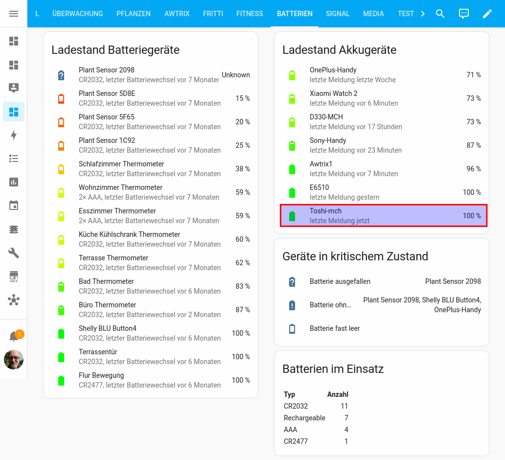

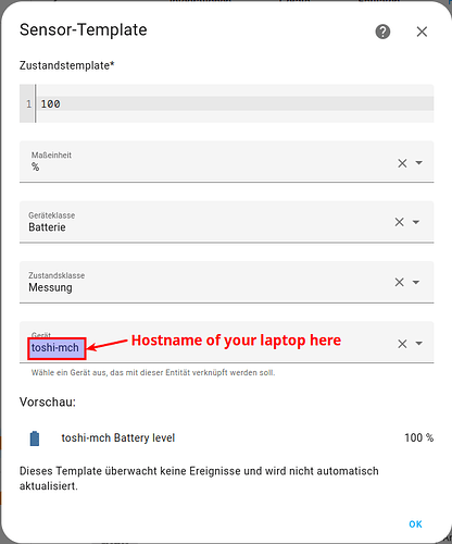

A little off-topic, but if you want to do things “right” in Home Assistant, also create a template sensor (using HA’s GUI Helpers) like so:
Then you can enjoy your Linux laptop battery state on your battery panel—here’s mine as an example:

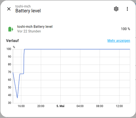

The lil Python script is just for Home Assistant fanatics like me—its only purpose is to update the battery status to HA (which in turn keeps track of the history).
