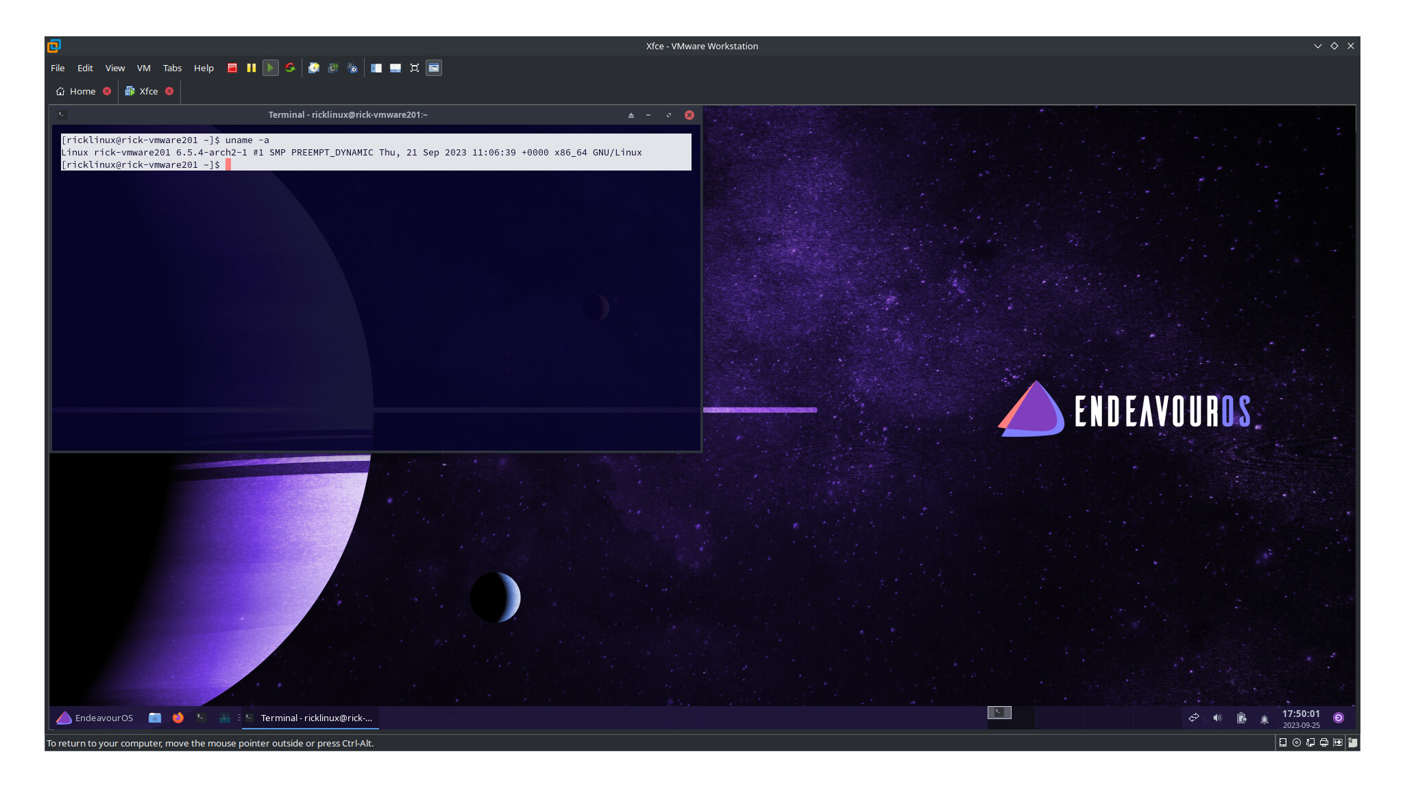

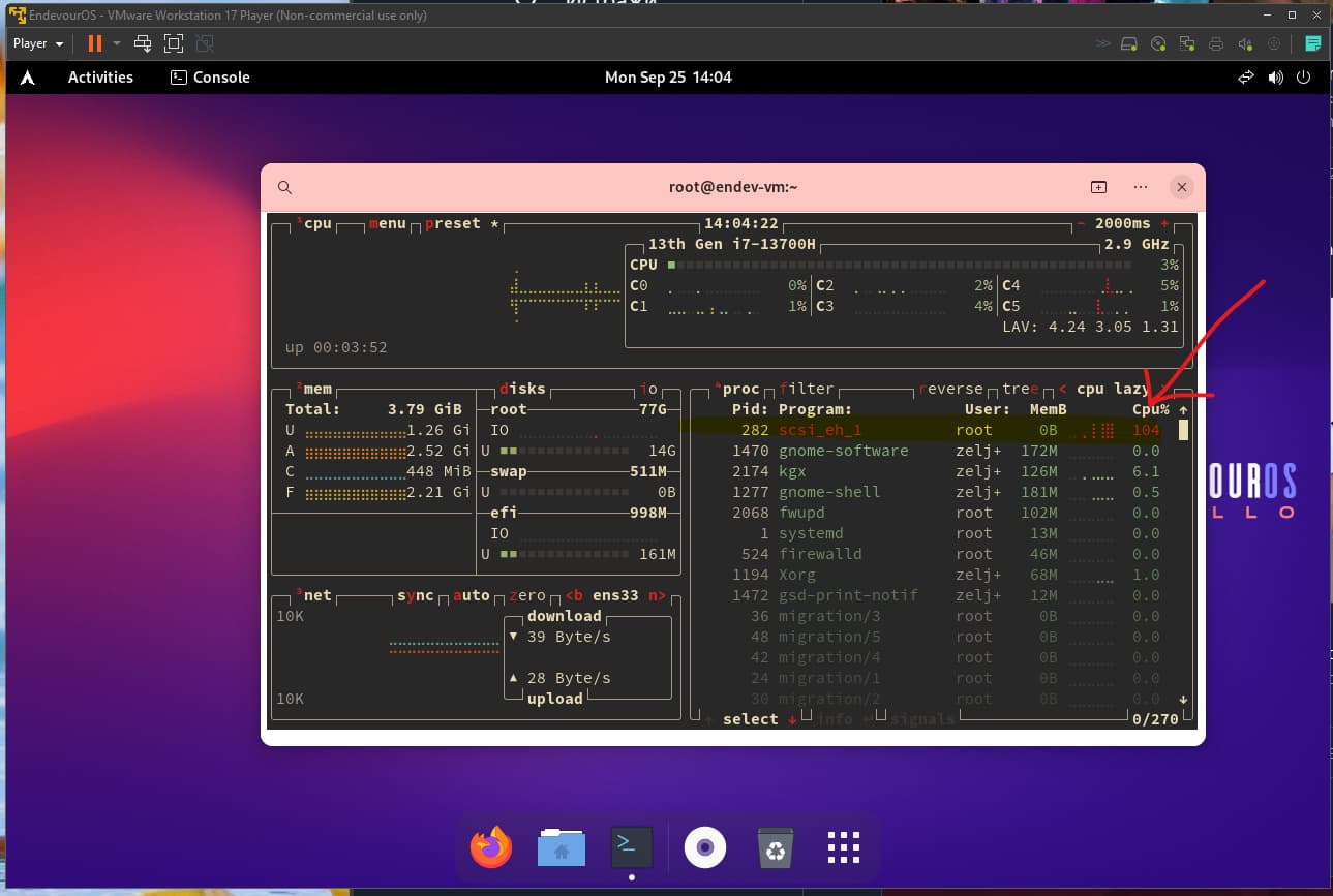

Edit: Yep, it seems that’s the culprit. Installed EnOS in a VMWare player just now. Barely usable VM with kernel 6.5, and everything works okay on 6.1 LTS
@Cookie
Edit: Also we have noticed on vmware that you need to set the settings to SATA instead of IDE. This is done under customize hardware, advanced and set to SATA.
