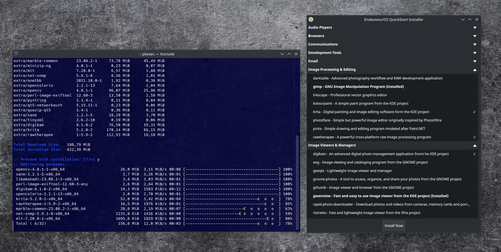

I don’t know why, but Quick Installer just won’t start, and I don’t know why because it worked just yesterday.
Try running it from the console and see what error it reports.
and what command should I use ?
[marcin@marcin-81de ~]$ eos-quickstart
eos-quickstart: symbol lookup error: eos-quickstart: undefined symbol: _ZNK11QQmlPrivate18AOTCompiledContext13getEnumLookupEjPi

the app itself needs to get rebuilded against changes on qt6.
I have triggered the package rebuild already will need some hours to get into the repo…

all these are just updated on arch repos…
And because eos-quickstart is build with qt6 it needs to get rebuilded against the changed qt6 ti be able to run on it…
Will be okay with next update…
Yes it works now :wink:
